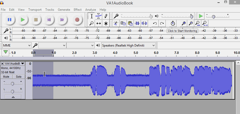

Hey Diver, your input level needs to be between a -6 and -12dbs. I do not think your lap top is capable of supplying the needed gain. Your RMS requirements are off to much to bring it into ACX compliance. You may want to try moving closer, 1 to 2 inches from your mic. If you can get your input levels to a -6 to -12 while keeping your noise floor close to the -60db max, you should pass. Check out the pic below.
“your input level needs to be between a -6 and -12dbs. I do not think your lap top is capable of supplying the needed gain. Your RMS requirements are off to much to bring it into ACX compliance.”
Crud. No way to fix that? I recorded a few chapters already. The moving screen shot goes by too fast to really capture what’s going on there. Can I fix it with RMS normalize like I think that’s showing? You said the laptop maybe can’t supply the gain, is it perhaps because I have the laptop sitting outside the closet I’m recording in, and a 7 foot USB cord? The laptop is very quiet so perhaps I could get away with having it in the closet with me. I could get a little closer to the mic though, a little more than a “shaka” away to avoid pops/clicks as much as possible. Do I have to start over?

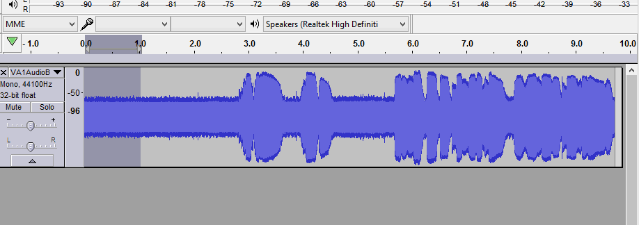

I guess you get different results with different operating systems. That explains a lot of why people are getting different results. I did follow the same directions that @Koz gave and you audio still failed according to my results. I also removed 1 sec from the head of your file. I slowed down the gif to give you a better view of what I did. RMS normalized to -18dbs then Normalized to -3.1. If I normalize any louder, your RMS Level will pass but you will fail the -3db max requirement.

OK, I was not able to get the audio clip to pass using the recommended procedure. However, I was able to get it to pass by removing most of the room tone as the gif shows below. I still think this is an input problem. To take this much effort to get a 10 sec clip to pass is one thing. To get a 60 min file to pass is another.

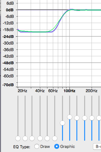

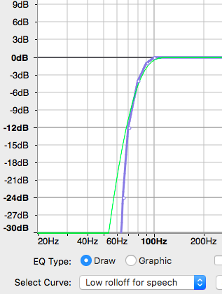

Is there any reason you’re using the Equalization tool in Graphic instead of Draw? Graphic restricts the range of Low Rolloff and can let some rumble pass by accident.

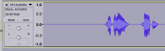

Also, I know people who edit the blue waves in dB, but I prefer regular waveforms because most of the performance is in the top 1/3 of the data. So dB is always watching waves that are never going to change. dB also gives you the impression there’s massive damage in your show, when it’s usually just not that bad.

As far as I know, using draw allows you to pin point your freqs by using customization. It has very little effect between the two settings. That’s why it is called “Draw”. It allows you to draw the curves you want. I did make sure it was set to 5,000. I tried them both and there was o difference.
The reason I asked about the DC offset is that all major DAWs recommend using a eq band set at 100 Hz to remove any low-end rumble. This is also what their DC offset filters do as well. It is simply a high pass filter set between 80 and 100Hz. If you combine this band with your eq settings, you can skip using a DC offset filter and this will help eliminate over processing. No need to do it twice. I do it all the time and hit 0.0 every time.
Low Rolloff

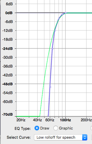

That hasn’t been my experience. In the draw mode, Low Rolloff is still reducing rumble at -70dB. The last step in the Nyquist code is -120dB at 50Hz. In Graphic, it peters out at -20dB, the natural range of the sliders. Do you know of a way to change the slider range?
20dB may not be enough if you have serious rumble or microphone problems.
If they do functionally match, then that may be an Audacity Unintended Feature.
