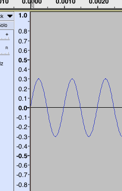

Hi :slight_smile: After a huge break I have a question. Is it possible in Audacity to create stereophonic sound signals and is it possible to generate sound signal as a rectangular impulse which has a specified duration and amplitude ?
A note.
You can’t actually stop and start tones like turning on a switch.
There is significant distortion at the stop and start points. It’s not pure tone. On pipe organs it’s call “chiff,” the difference between pressing the key and the time the note fully sounds. In electronics there are modulation effects that amount to the same thing.
Is this distortion going to affect the experiment?
Did I just uncover the reason you’re doing the experiment?
