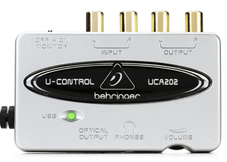

Early digital interfaces didn’t do this trick and they were of limited usefulness. Now, I believe they all do it. Even my little Behringer stereo interface will monitor its own output when you throw that monitor switch upper left.
Oh, and there’s one note about this. If you insist that Audacity send your live voice back to you and you throw the monitor switch we don’t know about yet, you will hear both with horrendous echoes.

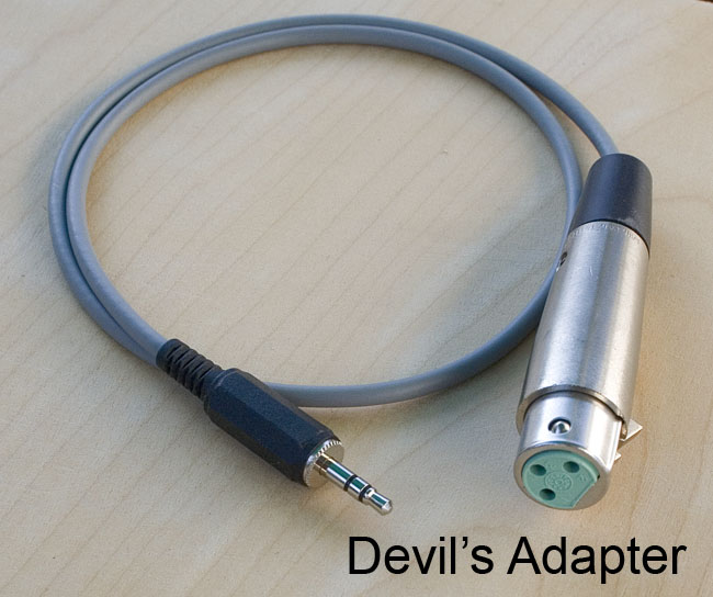

This is an 1/8" plug instead of 1/4", but the idea is the same.
A sound card is expecting Left-Sound, Right-Sound, and Ground working from the tip. What this adapter provides is Microphone Sound (XLR pin-2) , Out Of Phase Microphone Protection Signal (XLR pin-3) and Ground.
