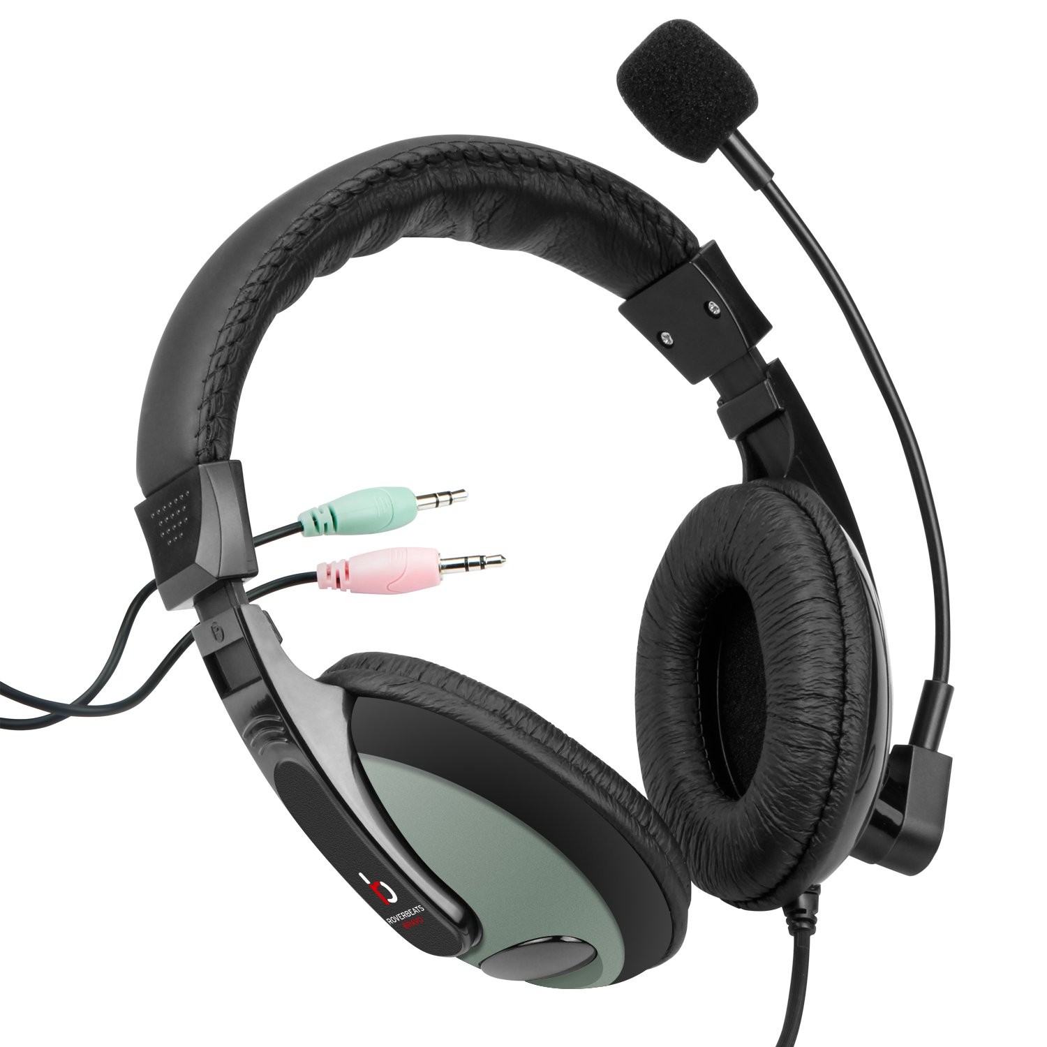

This does appear to only work with analog headsets like this (stereo or mono). Do you have such headsets?
http://www.kozco.com/tech/audacity/pix/PCHeadset.jpg

Terrific. The connections on the green headphone plug are Left, Right and Protective Shield. The connections on the pink microphone plug are Microphone Sound, Computer Battery and Shield. They may look like the same physical plug, but they're very much not wired the same.Here's what I have
Scroll down. You have one of each of these.
http://www.kozco.com/tech/audioconnecto ... ctors.html
