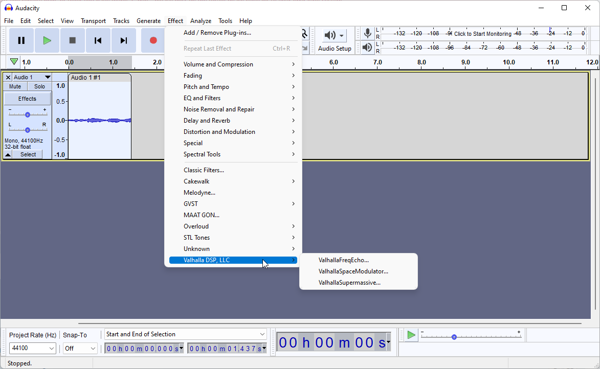

The default "Quality" setting in Audacity is to use 32-bit float, and as PGA wrote Audacity works internally in this format.
If you look on the left end of an audio track (just below the track name) the sample rate and bit format are shown. By default this is "44100 Hz" "32-bit float".
(see also: http://manual.audacityteam.org/man/Track_Drop-Down_Menu )
