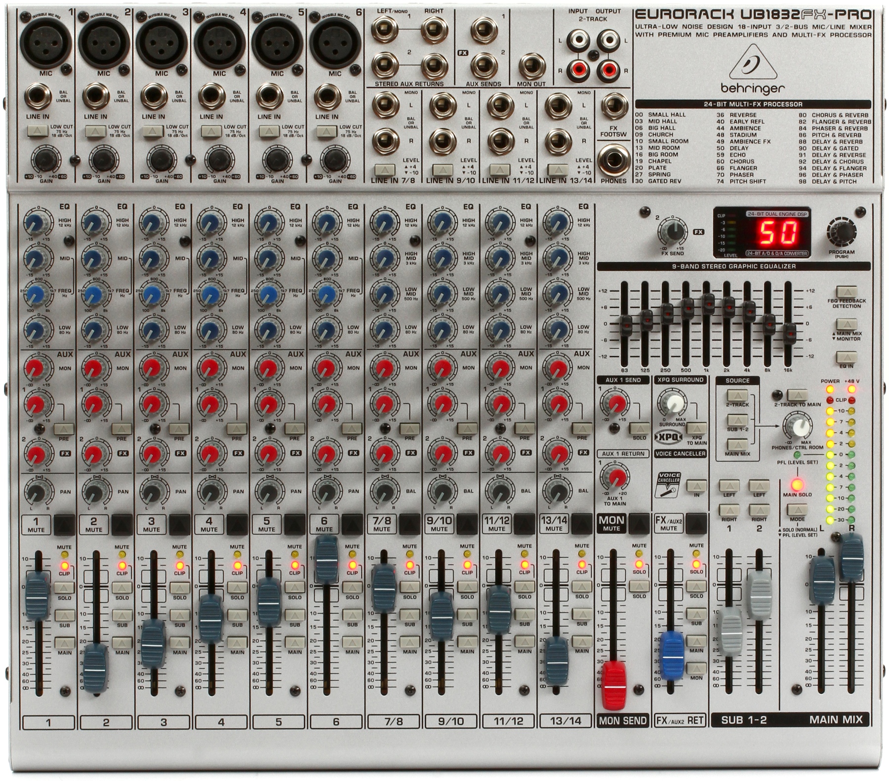

It would help a lot if we had a model number or picture of the boards your are working with. We might quickly recognize controls that you might have missed. It is quite possible that the board does not have any level control for the tape outputs separate from the mains. If that is the case you are pretty much SOL in being able to record with just the UCA-202 and get the levels right. If the amplifiers back in the closet have gain controls it is conceivable that you could lower the levels coming out of the board and make up for it by increasing the gain of the amps, but I wouldn't recommend that. If you are handy with a soldering iron, you could put together a 10 dB attenuator of a handful of $0.05 resistors and some phono connectors (probably $10 worth). Otherwise your best bet in that situation will be to invest in a better USB audio interface that has physical gain controls. (Or your own small mixer to use as a front-end for the UCA-202).
It's not very high quality, but here's a pic of the mixer board used for the Dance Assembly that my son took:
http://i.imgur.com/L46f4NQ.jpg
It was before we started recording. We only used two channels, one cordless microphone on the far left, and one of the CD players. We dropped all of the other sliders to zero, other than the main volume control on the far right. The UCA-202 cables plugged into the RCA jacks for the "tape out" at the top of the mixer. I tried to mark all of those in red text & arrows.

JeffB wrote: It's not very high quality, but here's a pic of the mixer board used for the Dance Assembly that my son took:
That helps immensely. I pulled up the manual for that board of the Behringer web site and fairly quickly determined that indeed the Tape Outs are wired in parallel with the main outs. There is no independent level adjustment. The board does have a "Monitor Bus" and a "Aux Bus" -- basically totally separate mixes that can be sent to external equipment. So if those outputs are not currently in use you could connect there (and I can see that they are not connected in your picture). They are phone connectors so you'd need suitable adapters to the RCA connections on your UCA-202.
The Aux controls are directly above the "pan" pot in each of the input sections. Only one of the two AUX busses can be set to be "post-fader" so if you want to use them as a stereo pair you'll probably want to set everything "pre-fader" and then carefully adjust the level for each of the sources, while monitoring with headphones and the meter in Audactiy.

JeffB wrote:It's not very high quality, but here's a pic of the mixer board used for the Dance Assembly that my son took:
Wow, nice detective work. That pic is pretty poor quality. I didn't even know it was a Behringer mixer. It is apparently wired differently than my stereo system, whose tape out monitor output is not affected by the volume control.
I've added green arrows pointing to the spots that I'm guessing are the Aux/Mon output jacks on the original photo. Correct?
http://i.imgur.com/yBIVpsW.jpg

JeffB wrote: Wow, nice detective work. That pic is pretty poor quality. I didn't even know it was a Behringer mixer. It is apparently wired differently than my stereo system, whose tape out monitor output is not affected by the volume control.
Not hard, all I did was google "Eurorack UB1832fs-pro". The first hit is the unit for sale at Sweetwater ($250) which oddly has a much better picture of the unit than the second hit which was the Behringer web page for the product. Here's the link to the user manual http://www.behringer.com/assets/UB2442F ... O_M_EN.pdf
JeffB wrote: This jack would work then?:
Metal 6.35mm (1/4 Inch) Mono Plug to RCA Jack Adaptor
Yep. If you think you are going to do this very much I would invest in 1/2 a dozen.
Not quite. Those jacks are the Headphone output, and the connection for a foot pedal to control the effects processor in the unit. The jacks you want are in the same top row as the Tape input/output but a bit further to the left. They are labeled "Aux Sends".
JeffB wrote: How does one set them to either "pre-fader" or "post-fader"?
There is a button labeled "Pre" next Aux level controls for each input. If I read the manual correctly that button only effects the Aux 1 send, the Aux 2 is always "pre fader". I also just now noticed that there are what appear to be overall gain knobs for both of the Aux sends. The Aux 1 knob is above the Mon Out fader, and the Aux 2 know is up just left of the controls for the built-in effects processor. Also next to the Aux 1 Send knob there is a "Solo" button which I would guess connects that output to the "solo" bus (Yet another cross bus). You may need to spend some quality time with that manual...
JeffB wrote: I'll probably have to rely on the Audacity meters for now. I don't have any decent headphones, though they're on my wish list as they're apparently important for editing audio books.
I find them important for any sort of critical work. You don't really have to spend a lot of money there either. I have a set of Sony MDR-V300s that I use for most stuff ($60 at Amazon).
JeffB wrote: The two mixing board (or more) setup was in the Church. This was the school's mixer used in this case for their annual Dance Assembly for the grade schoolers.
Ah, sorry. I somehow missed that the two events were two different venues. If you do get back to the church I suggest the same thing, take picture of the boards, then google the name and try to find a copy of the user manual online.
JeffB wrote: It sounds like you must be an engineer as well.
Guilty as charged :-)
JeffB wrote: Thanks. I'll have to check that out. I'm trying figure out how to put together a tiny little home studio for narrating audio books on a budget and I hadn't seen the Peavey models yet. I'll have to check out the forum on here for audio book production, which I haven't done yet. I've seen articles on a few different sites which give sometimes conflicting recommendations on microphones, and those decisions also impact what sort of interface/mixer one might need. It looks like a bit more reading up on the subject is required.
Yes you should go read. There are whole novels there of various folks adventures trying to do exactly that. The biggest challenge is to create a space that is quiet and free of echos. There is a long thread from one fellow working the closet of this apartment just off La Brea (an extremely busy street) here in Los Angeles.

Post by JeffB » Tue Mar 10, 2015 7:20 pm
flynwill wrote:Here's the link to the user manual http://www.behringer.com/assets/UB2442F ... O_M_EN.pdf
Great! Thank you.
I found them on that much better photo of the mixer board that you alluded to. I've been wanting to post a "how to" for folks using that sound system for awhile and that would be a perfect photo for that. Many are given the job of doing announcements at basketball or volleyball games or award ceremonies, trivia nights etc. and they have no idea of what to do with it. Even showing them how to turn it on correctly so they don't blow out the speakers would be a help.
JeffB wrote:How does one set them to either "pre-fader" or "post-fader"?
There is a button labeled "Pre" next Aux level controls for each input. If I read the manual correctly that button only effects the Aux 1 send, the Aux 2 is always "pre fader". I also just now noticed that there are what appear to be overall gain knobs for both of the Aux sends. The Aux 1 knob is above the Mon Out fader, and the Aux 2 knob is up just left of the controls for the built-in effects processor. Also next to the Aux 1 Send knob there is a "Solo" button which I would guess connects that output to the "solo" bus (Yet another cross bus). You may need to spend some quality time with that manual...
Thanks. If I understand it correctly then I would plug the UCA-202 into both of the Aux send jacks if I wanted to record in stereo and would level things out from channel to channel using the red gain knobs, pushing the 'pre' button for jack #1 in each column/channel. Then if I wanted to raise or lower the input into Audacity without affecting the sound levels playing into the speakers, I would use the main gain knobs for the Aux outputs, (labeled #1 & #1 in red on the pic of the mixer).
Are the things I've been calling "sliders" actually called "faders"? -- the sliders that control the volume of the individual channels, such as a mic or another input, such as a CD?
JeffB wrote:I'll probably have to rely on the Audacity meters for now. I don't have any decent headphones, though they're on my wish list as they're apparently important for editing
I find them important for any sort of critical work. You don't really have to spend a lot of money there either. I have a set of Sony MDR-V300s that I use for most stuff ($60 at Amazon).[/quote]
Thanks. That's a little less than the ones ACX had recommended on their "wish list page". I'll head over to the audio book forum here in a bit to find out more.
Will do. I'll see if I can find whoever set that all up as well, if possible, or at least someone who knows a bit about it. The music director got back to me and said she didn't know anything about the boards other than that some years ago she thought that they had installed some sort of recording equipment "in the back room" where the main board must be.
