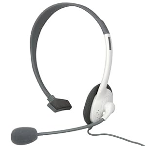

If you have a reasonable computer, you can use an analog headset.
http://www.kozco.com/tech/audacity/pix/PCHeadset.jpg
You may be able to use a USB headset as well, but that may not mix very well with game sound. Jury's out.
