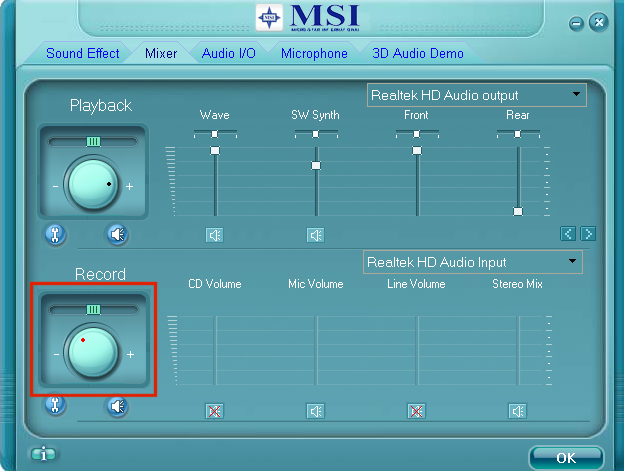

The sound card (hardware) is controlled by a "driver" (software). The driver has one or more user interfaces that control the inputs, outputs and other features of the sound card. On Windows there is usually a loudspeaker icon near to the time/date in the lower right corner of the desktop. Double clicking (sometimes right clicking) on this icon opens the interface. Typically this will look like an audio mixer, but there are a lot of variations from machine to machine.Genome wrote:I'm not sure what you mean by sound card mixer,
Often these "mixer interfaces" have multiple tabs, option buttons, and hard to find features, but as they are the primary means of controlling the sound card it is well worth spending time to thoroughly familiarise yourself with it.
Here is a typical screenshot of a Microsoft mixer interface (Win XP) showing the recording section (note the "options" menu - other stuff hidden in there).
Here is a typical screenshot of a Realtek HD mixer interface showing the recording section (note, lots of tabs and buttons with all sorts of stuff hidden behind them)
