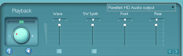

I don't really know, actually. I've tried both recording from stereo output and mic and each, both recording sound, both recording the artifacts. After setting the realtek audio manager's output to a lower level (almost non-existent), the recording sound normal, but they're still tons louder than anything I recorded. Are there any ways to "muffle" recordings, or a way to figure out why sound is apparently being played at a far higher range than what the speakers are actually delivering?
That's how low it was set when the distortions ceased. This forces my speakers to be set at a much higher level in order to hear sound at all. Which doesn't help the other half, because even if the sound can be recorded at a lower level, it's still louder than what my speakers send out ._.

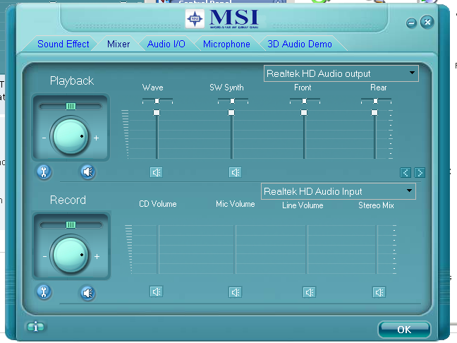

The problem is to do with the "Record" level rather than the Playback" level. We need to see the lower half of the realtek audio manager. Could you post a screenshot of the whole realtek audio manager interface.
Re: All sound recorded with static :(
There's the entire interface. I'm trying to record audio playing through programs and games on my computer.
EDIT: I tried setting the recording volume lower and it helped enough to be standable. Thanks for the help for this easy, yet overlooked, problem of mine ^_^

In the bottom left hand coirner of the Realtek dialog box you posted there is a big round knob - you have it set all the way round to the right i.e. maxed out at "11" like Spinal Tap - this is why you are getting clipping. Try turning it down a bit - click and drag on it with your cursor.
WC
