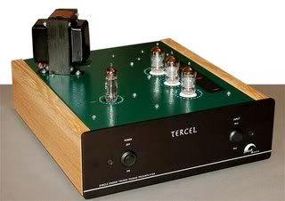

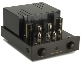

The preamps that I list are far from "the fancy ones". These are all entry-level units. I wouldn't even consider using a $20 preamp. I have owned the Parasound amp it is quite decent. I bet you can find a used one for $75 or so. I have also listened to the Nad and the Pro-ject and they're all good. For this price one is not going to stand out from the other. The Bellari on the other hand is a recommended piece from Stereophile magazine as well as many other mags and sites. I use a Counterpoint SA 3.1 & a PrimaLuna Prologue Three and plan on getting a Juicy Music Tercel soon.
