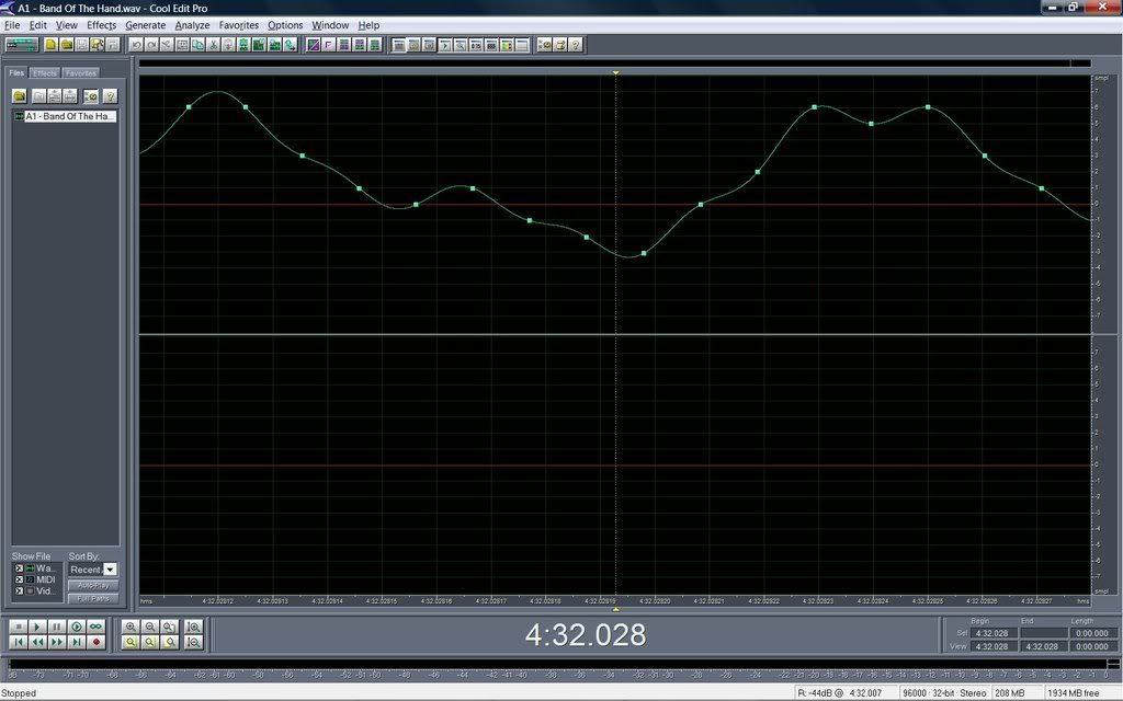

This is supposed to be a 24bit sample:
http://i153.photobucket.com/albums/s225 ... ndHand.jpg
look how all the values fall exactly on each line -- the 16bit values.

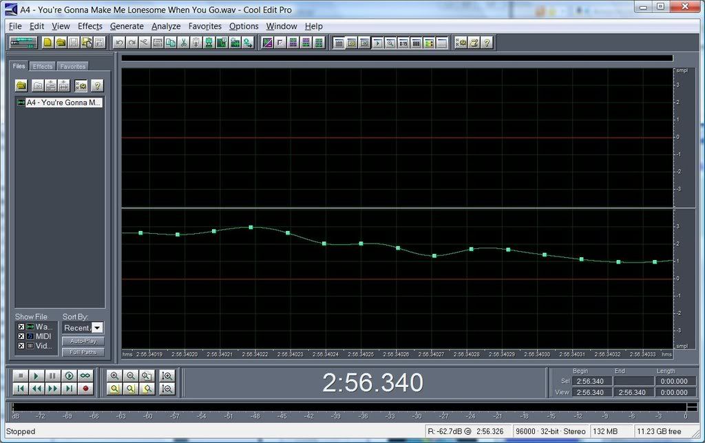

This si a "true" 24bit sample:
http://i153.photobucket.com/albums/s225 ... SAMPLE.jpg
Notice how the samples fall in-between the 16bit values.
