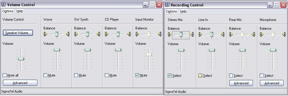

Can you record anything with Windows Sound Recorder?
If not, check the settings in the Windows Mixer (Loudspeaker icon near the clock) - Check both the Record and Playback settings.

No, Windows Sound Recorder doesn't work either. My sound settings look fine.
http://img.photobucket.com/albums/v123/ ... _audio.jpg
Anything wrong there?

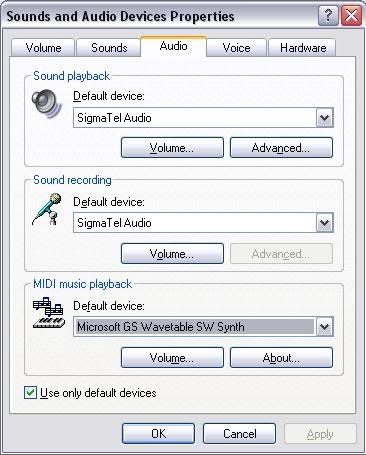

That looks fine to me.
Open up the Windows control panel and find "Sounds and Audio Devices"
On the "Audio" tab, make sure that the SigmaTel sound card is selected for recording and playback. You can also try ticking the "Use only default device" check box.
With these set, you should be able to get Audacity working with "Microsoft Sound Mapper" selected in "Edit > Preferences > Audio I/O"

Those settings are all already set.
http://img.photobucket.com/albums/v123/ ... sound2.jpg
