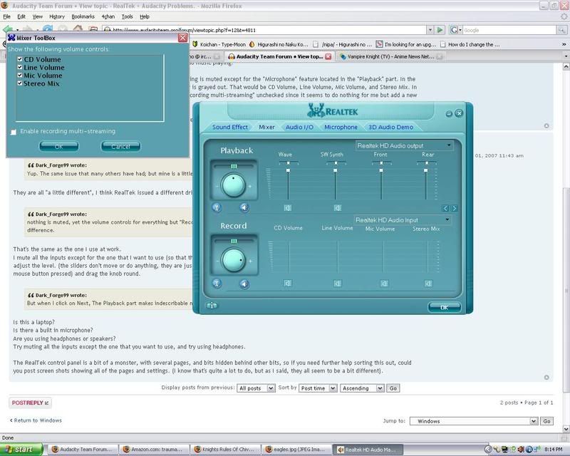

Yup. The same issue that many others have had; but mine is a little different.
I'm using XP Pro SP2. In my Volume Icon located in my system tray, in the RealTek HD Audio Input tab, nothing is muted, yet the volume controls for everything but "Recording" can't be moved. They are grayed out. They can be muted, but it makes no difference.

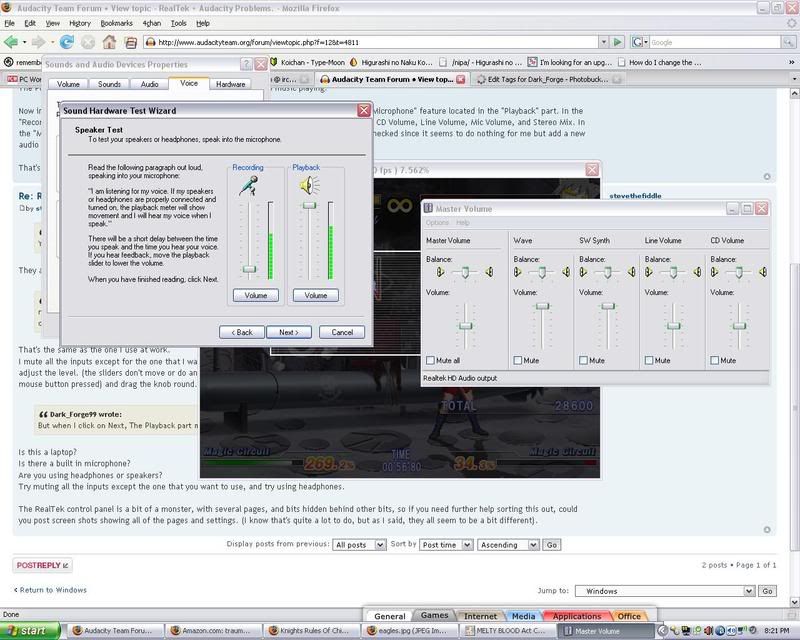

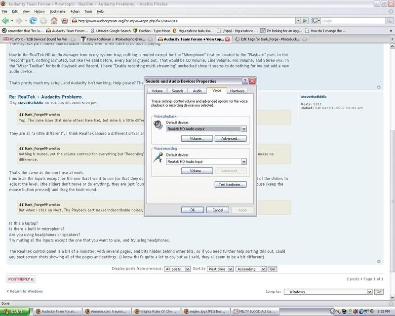

In the "Sounds and Audio Devices Properties" window located in <Control Panel -> Sounds and Audio Devices>, under the "Audio" tab, the Sound playback device is set to "RealTek HD Audio output", while the Sound Recording device is set to "RealTek HD Audio Input". Also, this is the weird part for me. In the Voice tab tab, when I click on "Test hardware", the Recording part is detecting music being played. And it comes out smoothly. But when I click on Next, The Playback part makes indescribable noises, even when there is no music playing.

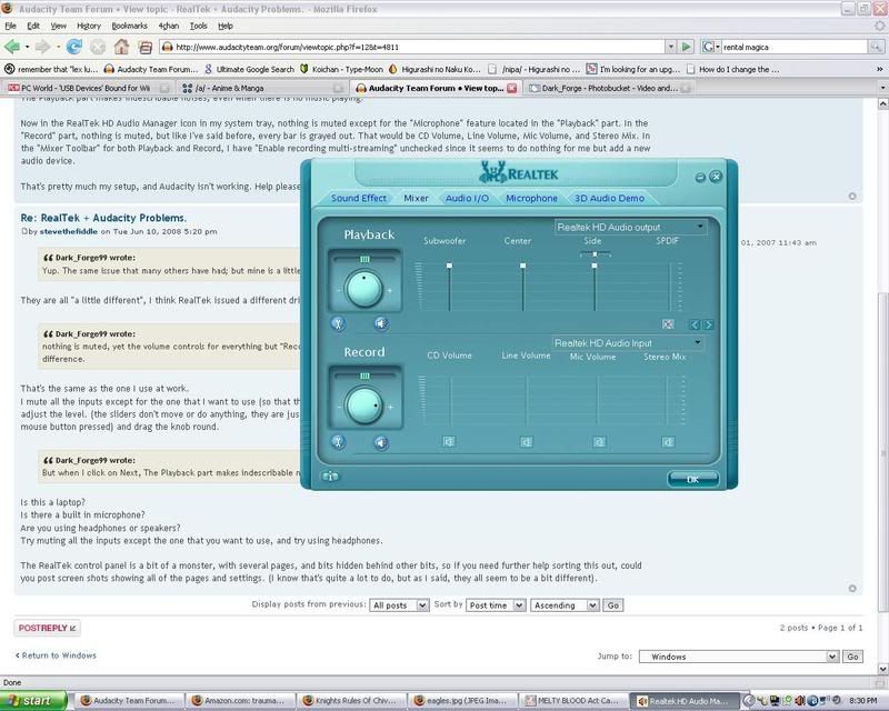

Now in the RealTek HD Audio Manager icon in my system tray, nothing is muted except for the "Microphone" feature located in the "Playback" part. In the "Record" part, nothing is muted, but like I've said before, every bar is grayed out. That would be CD Volume, Line Volume, Mic Volume, and Stereo Mix. In the "Mixer Toolbar" for both Playback and Record, I have "Enable recording multi-streaming" unchecked since it seems to do nothing for me but add a new audio device.
That's pretty much my setup, and Audacity isn't working. Help please? Thanks.

The RealTek control panel is a bit of a monster, with several pages, and bits hidden behind other bits, so if you need further help sorting this out, could you post screen shots showing all of the pages and settings. (I know that's quite a lot to do, but as I said, they all seem to be a bit different).

http://i9.photobucket.com/albums/a59/Da ... itled1.jpg
http://i9.photobucket.com/albums/a59/Da ... led2-1.jpg
http://i9.photobucket.com/albums/a59/Da ... itled3.jpg
http://i9.photobucket.com/albums/a59/Da ... itled4.jpg
http://i9.photobucket.com/albums/a59/Da ... itled5.jpg
http://i9.photobucket.com/albums/a59/Da ... itled6.jpg
http://i9.photobucket.com/albums/a59/Da ... itled7.jpg
http://i9.photobucket.com/albums/a59/Da ... itled8.jpg
http://i9.photobucket.com/albums/a59/Da ... itled9.jpg
I won't use IMG tags on them otherwise they would be a bother, but here are the links to pictures showing my settings.
