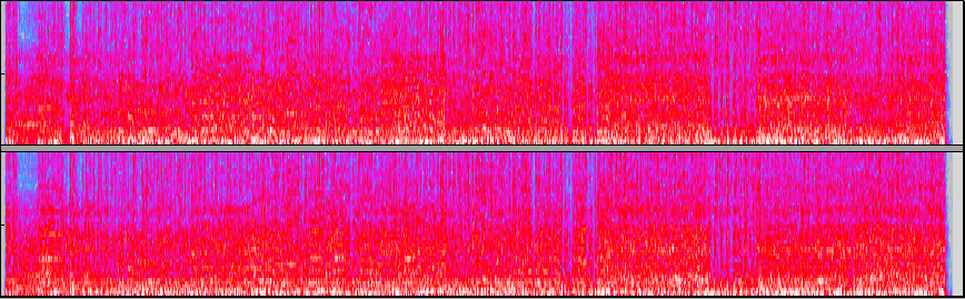

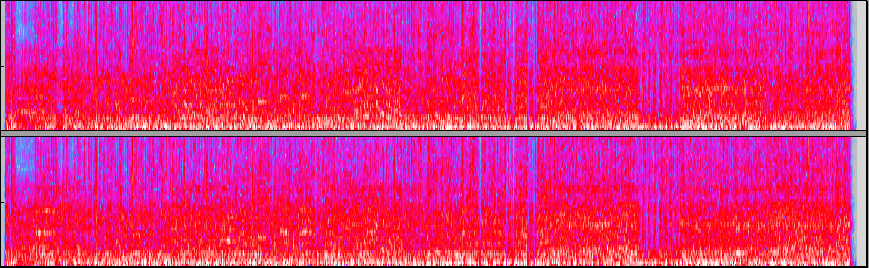

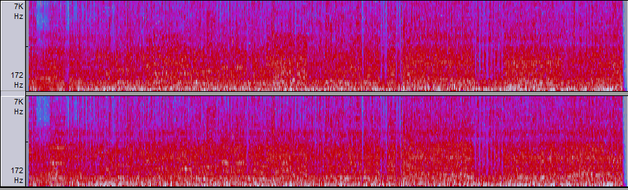

Hypothetical situation:
I have an audio file that I suspect is a transcode, ie. Transcoded from 128 to 320 kbps.
I now also have a legit 320 kbps copy.
Here is an example of the suspected transcode (spectrum mode)
Here is an example of a legit file (spectrum mode)
Would I be correct to assume that the more red or bright yellow/white there is in the top part of the image the more likely it is to be a transcode or is it just due to the content of the file?
Note: The two images are not of the same file

ShannenName wrote:Would I be correct to assume that the more red or bright yellow/white there is in the top part of the image the more likely it is to be a transcode
No, that is not a safe assumption. There is very little spectral difference between a 128kbps encoded file and a 320kbps encoded file. The difference due to the content of different recordings will be much more significant than the small difference in spectrum due to the encoding.
You may notice in the "Frequency Analysis window" (Analyze menu > Plot Spectrum) that a transcoded 128>320kbps file has a frequency cut-off at around 16kHz, but this is not "proof" that the file has been transcoded. There could be other reasons why frequencies above 16kHz are absent. Similarly, the presence of frequencies above 16kHz does not prove that the file has not been transcoded, though it would suggest that this is probably the case.
Just because a file is encoded in a high quality format (320kbps) does not necessarily mean that it will be high quality. 320kbps is capable of high quality audio, but it is still possible to make a badly encoded file, even at 320kbps. For example, MP3 encoding will often boost the peak level a little which can result in clipping distortion - it is therefore best to allow a little headroom before encoding. A 320kbps MP3 that has clipping distortion will almost certainly sound worse than a 128kbps encoding that does not have clipping distortion.

stevethefiddle wrote:No, that is not a safe assumption. There is very little spectral difference between a 128kbps encoded file and a 320kbps encoded file. The difference due to the content of different recordings will be much more significant than the small difference in spectrum due to the encoding.
Thank you this is what I suspected but a friend of mine seemed to have a different idea.
Didn't know about the 16khz cutoff though but now that I think about it, it seems logical as lower encodings sometimes cutoff frequencies that we can't hear or can't hear as much.

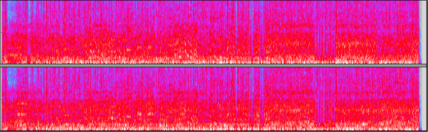

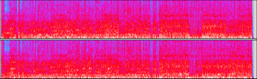

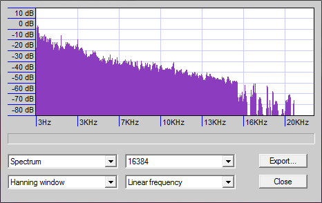

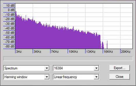

Here are my results:
128 kbps:
Spectrum View
Analyse->Plot Spectrum View
160 kbps:
Spectrum View
192kbps:
Spectrum View
320 kbps:
Spectrum View
Uncompressed WAV:
Spectrum View
128kbps transcoded to 320kbps:
Spectrum View
128kbps transcoded to WAV:
Spectrum View
Conclusion:
As you can see the 128 file is the same as the 128 transcoded to 320 and the 128 transcoded to wav therefore they sound EXACTLY the same.
From 128 to the legit WAV you can see a decrease in the drop off of sound (in plot spectrum view) after the 16KHz therefore resulting a better sounding (subjective) music file.
In spectrum mode there is little difference between bitrates and therefore using spectrum mode to detect transcodes in NOT an effective or reliable way to detect transcodes.

In Audacity 1.3.12 if you go to "Edit menu > Preferences > Spectrograms" you can adjust the settings for the spectrum view.
Increase the "Window Size" for higher resolution (at the expense of slower rendering).
If you increase the "Maximum Frequency (Hz)" you will be able to see the high frequency drop off for low bit rate MP3s.
