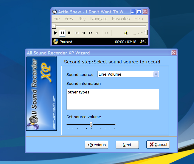

Turbobob, Sorry for the delay in replying but was away on a long week-end and did not get back till last night (late). I am not really sure what your problem is or what OS you are using, I assume it is Windows XP as the problem does not exist in 'Vista' (see most recent posting on the Forum). Just to recap, my problem was all about not being able to record sound from the computer such as on stream radio or music being played via the speaker system. My problem was wholly associated with the Realtek Chip and MSI Motherboard as detailed at the beginning of my posting on the 'Forum'. If you read all the pages on the Forum and compare the screenshots with those of your own you should be able to find a solution but make sure you are comparing like with like, different sound chip/motherboard combinations might be a problem. I would not worry too much about options being greyed out as mine still are but nevertheless I can record sound. I was using Audacity software at the time but I now also use 'All Sound Recorder XP' and this is ok as well and I have the choice of MIc.; Line ; or Stereo Mix. These options are greyed out in the Master Volume Recording Options window but they do work.
I would recommend that you read all the pages on the Forum and if your problem is the same as mine's was and your Motherboard/Sound Chip combination is the same or similar then you should be able to solve the problem.
