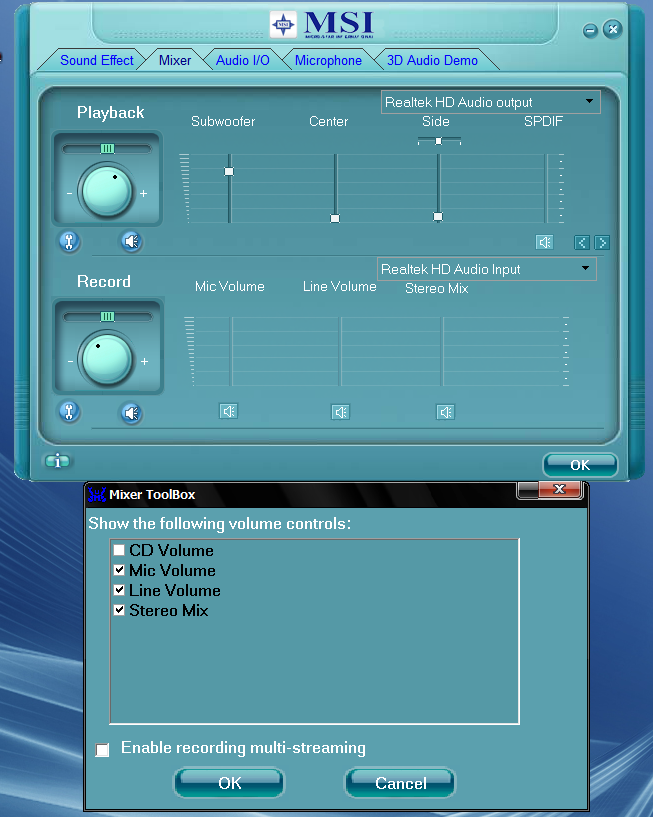

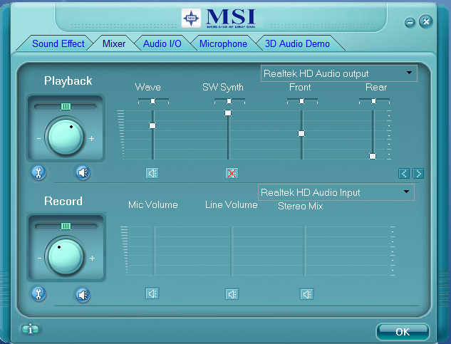

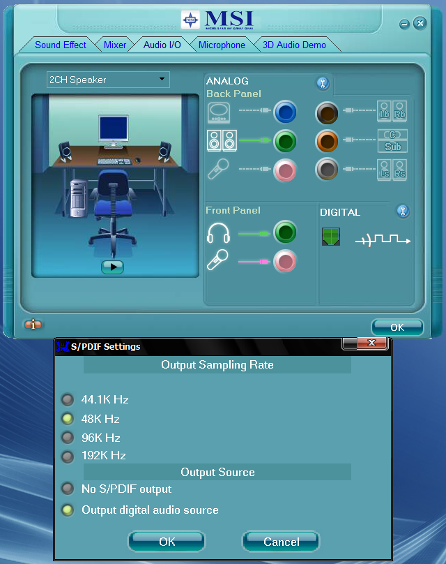

Here are the screen-shots you asked for.
IMG]http://i261.photobucket.com/albums/ii46 ... Audio3.png[/IMG]
The Playback options are not a problem but basically I only activated the ones associated with my 2-Speaker, Subwoofer set-up.
I hope they are what you are looking for if there is something i might have omitted, let me know.

It took me a long time to figure out after loading all posible downloads. When you have the realtek control panel up on the screen you have to adjust the volume control using the knob as a control to turn up the volume. The plus and minus signs are just for letting you know which way to move the knob with your mouse. You are no longer using the microsoft volume controls for your recording. I could never get the recorder to record or even have it pick up any volume until I tried the above steps. I hope this helps you in some way shape or form.

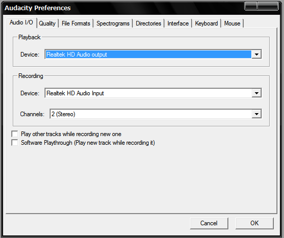

Hi guys, Ive just bought a usb turntable which came with Audacity (ver 1.2.6) i first installed Audacity with no problem, then connected the deck up via the usb, a little box popped up in the bottom right saying hardware found and installed, but the input device box on the mixer bar is greyed out, i followed the instructions on the Audacity website and it says i need new (non window) drivers for the sound device! the driver update does nothing so i was wondering if you guys know exactly what i need to install and where to find it as id like to convert my vinyl into mp3 but without audacity working the deck it useless :cry: any help would be great :) p.s i have windows xp with no extra sound upgrades to my pc, if you need anymore info ill be happy to find out so i can fix this 8-)
steve
Site Admin
Posts: 81629
Re: Unable to record
Post by steve » Sun Mar 16, 2008 9:26 pm
adamski wrote:i first installed Audacity with no problem, then connected the deck up via the usb, a little box popped up in the bottom right saying hardware found and installed, but the input device box on the mixer bar is greyed out,
Go to "Edit > Preferences > Audio I/O" and select the USB audio device as the recording device, and your soundcard as the playback device. If you need any more help please start a new topic.
