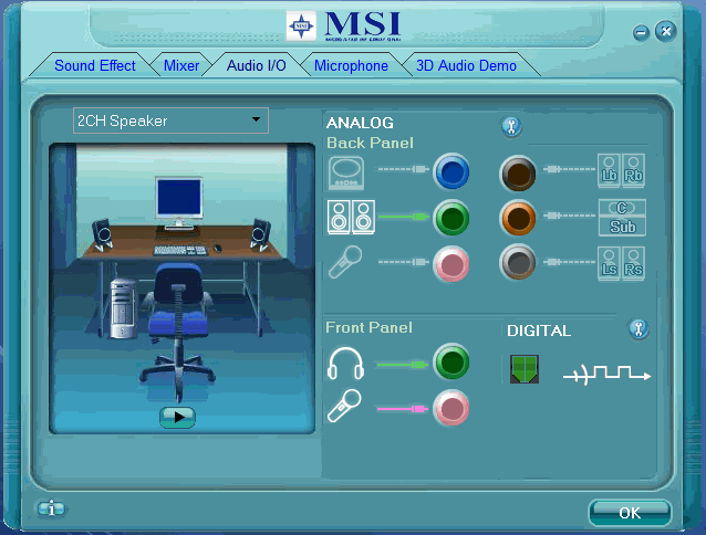

Could you post a screenshot of the MSI Audio Manager with the "Audio I/O tab selected.

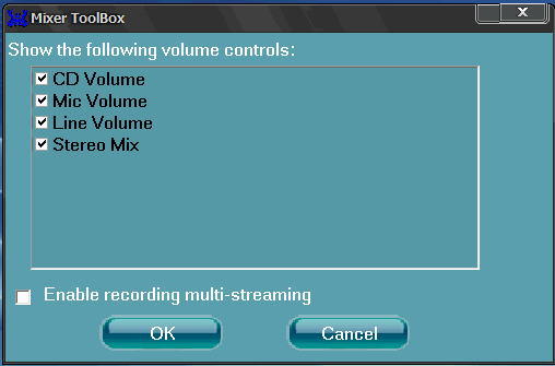

Over the past two months i have got to know the MSI Audio Manager very well and i don't think there is any option or screen that i have not tried. Here is the screen shot you asked for . I have also included a screen shot of the Mixer toolbox (Recording Input Options) this is what you see when you click on the 'spanner icon'.
The other icon (Spkr.) is a 'mute' option.
I am not sure what you mean by the "("<" and ">") below where it says "Realtek HD Audio Input" these are above the Input but below Output. They just give more output options to accommodate the 8-1 speaker configuration and also front and back connections
Hope all of this helps and that I have answered your queries. If not let me know.

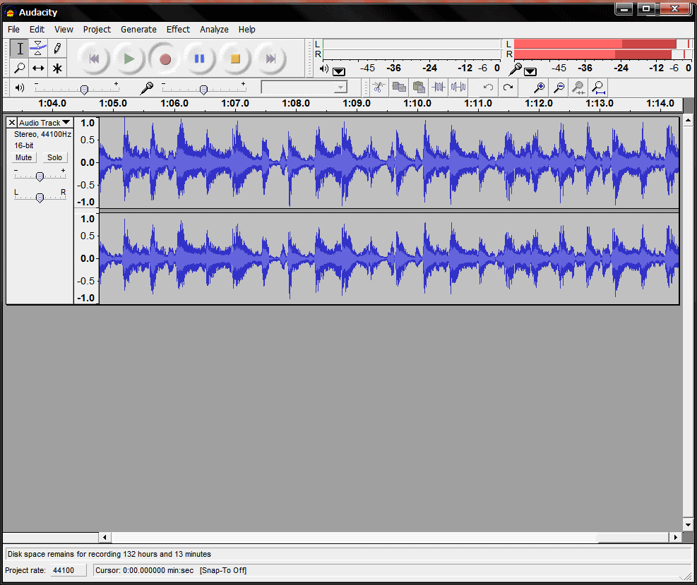

Managed to produce a 'wave-form' on audacity but not a proper one, consequently the play back is very distorted and could not be listened to but at least it is a step up from a straight line. The Audacity Record preference was set to "Microsoft Sound Mapper"

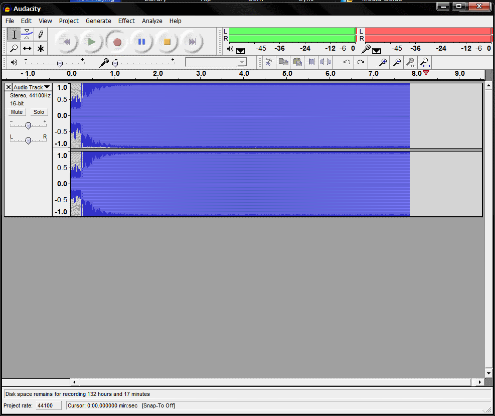

I don't know whether things have got better or worse. I left the problem after posting my previous screenshot and after a re-boot later on in the day I went back to the problem and attempted another 'recording'. The screenshot shows the new problem, the noise levels from the speakers were extreme and the volume meters are 'off-the-map', also both volume meters are showing (green and red) normally I only see red. The wave file looks an interesting shape but it was as quick as i could take the screenshot and switch off as the noise really was unbearable.
After this occurred I downloaded Audacity v1.2.6 but this has made no difference. Is this latest problem an Audacity one?. I have checked volume settings on the MSI Audio Manager and they are set quite low.
