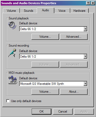

Posted: Thu Sep 24, 2009 12:48 am
by Kizzume
This is what I get.

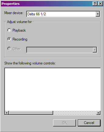

Just a thought - you've not shown any screenshots of the Windows Mixer.
On XP it is usually possible to enable the Windows Mixer for any sound card (though the options in it may be limited). I can't remember off the top of my head how to enable the Windows Mixer, but it is somewhere in the Windows Control Panel.

by Kizzume
The Delta 66 drivers disable the windows recording mixer. I posted that information in the following thread. http://forums.m-audio.com/showthread.php?t=12270
but here are screenshots
