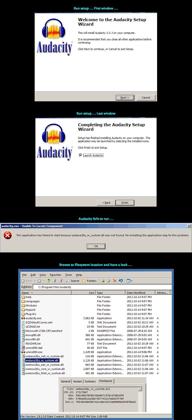

whenever starting Audacity on an XP system, a popup appears stating “This application has failed to start because wxbase28u_vc_custom.dll was not found. Reinstalling the application may fix this problem” (see attachement) for detailed image…
Audacity versions used:
2.0.3 as build from svn
2.0.2 as downloaded from your site
2.0.3 was build against wxWidgets 2.8.12 both with ASIO and without ASIO support on a win7 machine with Visual Studio 2008 according to the respective build instructions.
Both versions run fine on the win7 machine, both versions terminate with the mentioned error on the xp machine.
Thanks for your kind support
Marcus

The usual answer to launch problems on XP is to install or repair the Microsoft Visual C++ 2008 SP1 Redistributable Package (see http://manual.audacityteam.org/o/man/faq_installation_and_plug_ins.html#probs ), though launch errors normally say the “configuration is incorrect”. Especially if you built on Win 7, try the Redistributable Package.
If that does not help, right-click over audacity.exe and try different compatibility options.

You mean installing the Redistributable package on the xp machine? Gonna try that…
Thanks for your quick response!
Marcus
Yes, please try that…
