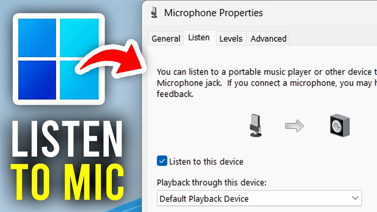

And/or try Listen To This Device to make sure Windows is getting a signal.

In spite of the continuing changes in Windows 11 settings I would still recommend typing the mmsys.cpl command in the windows run option panel. Before opening Audacity this is where you can check your recording and playback devices and where you will also find the “listen to” option for any recording interface.
If the equipment you use does not show up in this control panel there could be problems with hardware or drivers which should be checked using “device manager”.
After establishing that your recording equipment is working then take a look at permissions in settings - privacy and security-
