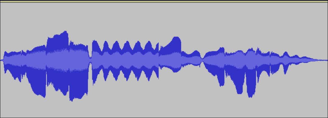

Actually, the problem is Equalization effect removes previous edits made by the Envelope Tool. That’s why after apply Equalization, track patterns are changed (to the one before Envelope edit). Please see screenshots below for details:
This is the track with Envelope edit shown in the white areas. Equalization or Base & Treble effect will be applied to this track below:
After apply Equalization effect, Envelope edit is removed so the track pattern is changed to the one before Envelope edit and the white areas are gone too:

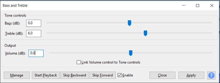

Base & Treble effect with Base=0dB and Treble=6dB to make it close to Equalization change above:
After apply this Base & Treble effect, track patterns are unchanged as Envelope edits are not removed so the white areas remain:

Our envelope tool has problems. If you want to apply an envelope correction “forever” then Tracks > Mix > Mix and Render afterwards.
Then your work turns into a regular, normal track with the corrections burned in.
Thanks for the information. It helps. Tracks > Mix > Mix and Render works. It can burn Envelope edits in a new track.
A side question if you don’t mind… what does Base & Treble effect with Base=0dB & Treble=6dB look like in Equalization curve? Is it close to the screenshot below? In other words, which frequency range does Treble (in Base & Treble effect) boost up.

Tone controls are intended to work like the two knobs on the front of your home music system. They’re intentionally sloppy.

Based on your screenshot, it seems Treble in Base & Treble effect boosts frequency from 1 KHz and up. I’m trying to create MVs with sax solos. By playing with different settings, it looks like Treble=6-8dB will make sax sound brighter. By using Equalization instead of Base & Treble, I hope I only boost 1 KHz - 3KHz, and not to boost high frequency beyond 3 KHz. Otherwise, it may sound like it has some noise.
