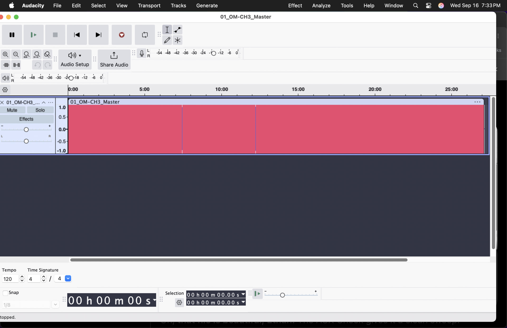

I’m narrating an audiobook using Audacity 3.7.1 on a MacBook Pro running macOS Sequoia.
My finished Audacity project looks and sounds normal. Before exporting, ACX Check gives these passing results:
Peak level: –3.10 dB
RMS level: –22.68 dB
Noise floor: –77.16 dB
However, after I export the chapter as a WAV file and import that WAV into a new Audacity project, the entire waveform appears as a solid red block and sounds distorted in Audacity.
The strange part is that the same exported WAV sounds normal when played in QuickTime Player. I also completely re-recorded the chapter, but the exact same problem occurred after exporting and reimporting the new WAV.
This has happened with multiple chapters. The original Audacity projects look normal; the problem appears only after exporting the WAV and importing it back into Audacity.
I’ve attached screenshots showing:
  1. The original project with its normal waveform and passing ACX results.
  2. The exported WAV after it was imported back into Audacity, showing the solid-red waveform.
Is this an export problem, an import/display problem, or a known Audacity issue on macOS? What information or settings should I check?
Thank you for your help.

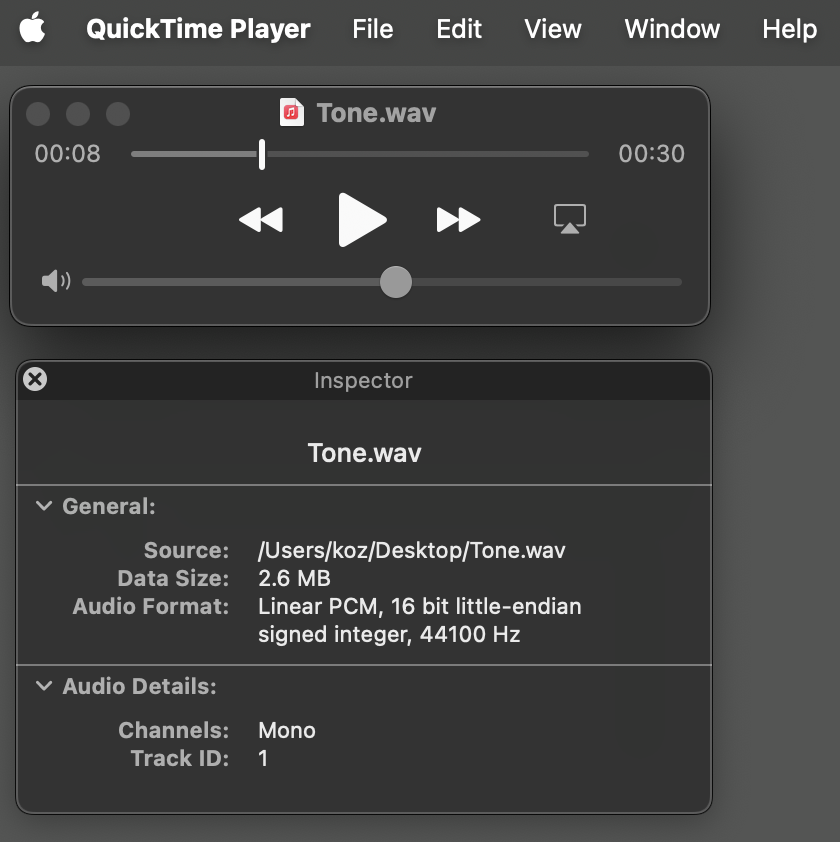

It’s a good idea to inspect the file in an application that’s not Audacity.
I created a simple tone file:
I exported it as WAV and then opened it in QuickTime Player.
Quicktime Player > Window > Movie Inspector
That’s a little hard to see. I like dark gray desktops. The top is the actual player and the bottom part is the analysis. Note that it’s a mono file at 44100 Hz sample rate, 16 bit.
See if you can analyze my file…and then yours.
You may be accidentally exporting in the wrong format, (wrong bit-depth ?).
