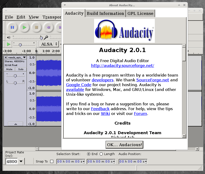

While running ‘audacity’ from a terminal, I got some more clues (too long to detail for this post), and decided that maybe I should see what the latest stable ‘audacity’ release had to offer. Well… I decided to compile the latest version (which is 2.0.1) to replace the initially installed version (which was 2.0.0), and see if that made a difference.
I had some initial resistance to doing this because I had seriously wanted this installation to be relatively free of clutter, and devoted solely to music-making. So much for that plan. Onward.
So, checking dependencies, I installed what was necessary. > Well, there were a few packages, notably, “nyquist:i386”, and “libavcodec53”, which caused synaptic to desire to uninstall, among other things, the entire KXStudio meta. So, I declined to install these “dependencies” (and ask, maybe therein lies further clue to this ‘problem’?) >
I compiled ‘audacity 2.0.1’ with success.
Running it, I experienced the same lack of ‘audacity’ to recognize ‘jack’, the same stopping of ‘jack’ when ‘audacity’ was run, and no real difference (as far as the problem goes) that I could easily detect. :sadness:
