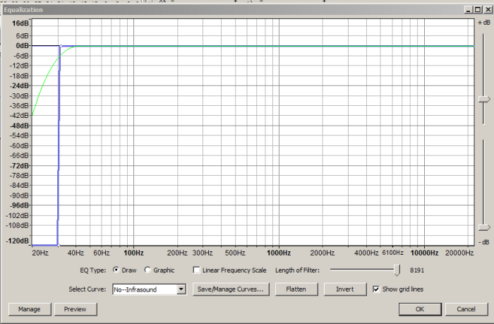

If you apply equalization to remove infrasound, the “big dipper” should disappear …
No-Infrasound.XML (187 Bytes)

That custom filter should get rid of them, but it’s best to not make them in the first place.

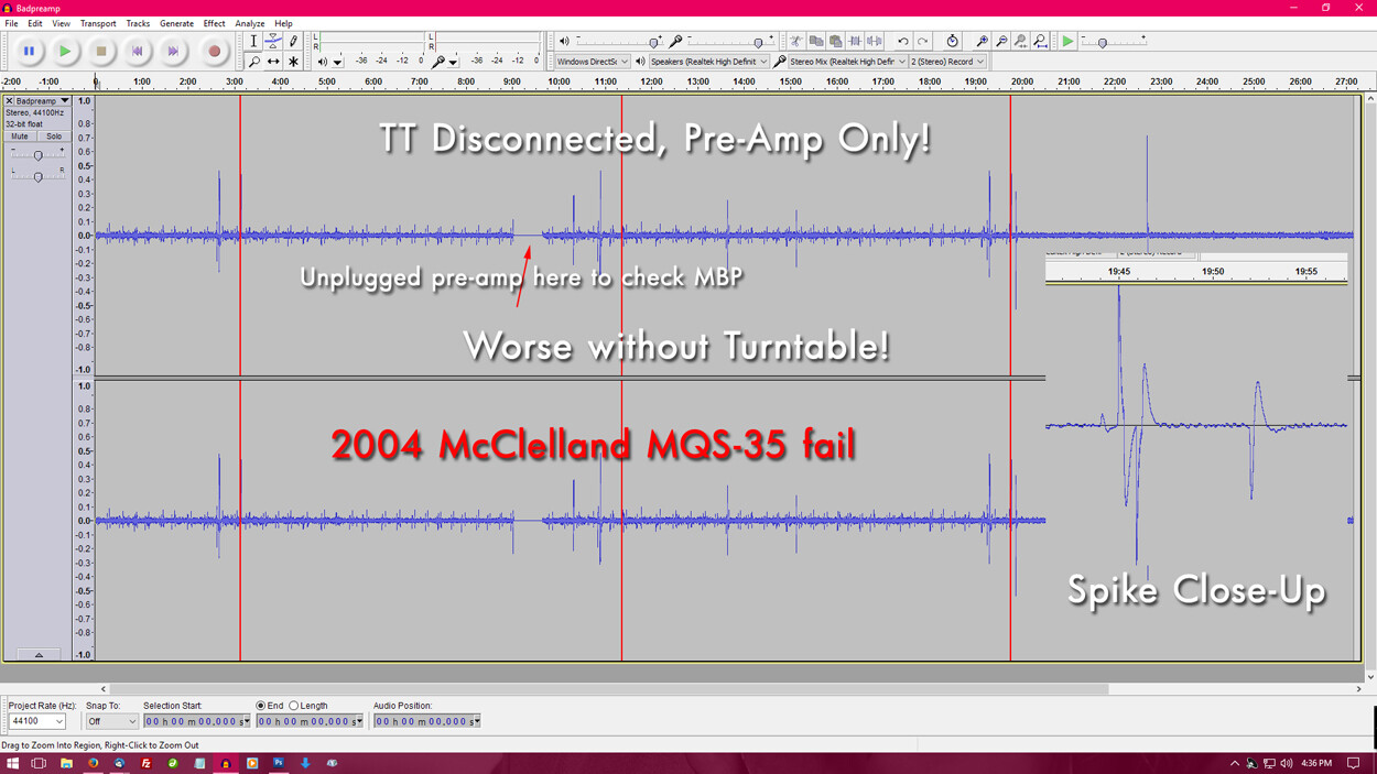

The way I would approach it is to try making some half hour recording of “silence” with everything set up as normal, and everything turned on, but with the turntable disconnected from the preamp. It’s important that everything else remains exactly the same as if you were recording an album. By changing exactly ONE thing at a time may show where the fault lies. If the problem occurs with the turntable disconnected, then we have ruled out the record, cartridge and turntable as the source of the problem.

Wow so many great responses! Thanks. Yeah - that’s my MBP 2009. Figured the SSD and just the tiny fan would be the least noise. Downloaded the filter xml. I was trying to find a way to remove them after the fact and that oughta do it. Like the idea of recording a half hour of silence with TT detached. Should prove something, but what to do about it? The Thorens is a 1975, but kinda sat for about 15 years. Replace some caps maybe. Both of my systems can do sub 30, but it is a very short pulse. Might be easier to watch the sub move than it would be to hear it. Never had any problem with the analog McClelland. Question: If I use a USB preamp is the DAC done in the preamp and not the MBP? Just always thought keeping the sig analog going in was best and eliminating any USB drivers? Last question: Although it’s inaudible, the Audacity recording meters are always bouncing a little when the TT is live but nothing is playing. Is that normal or should there be complete silence? It’s always below -36 but concerns me. Thanks again.

Pre-Amp FAIL - Sorry to bother everyone with such a fundamental issue. I guess my fancy British Pre-Amp is Junk. Might not have been, but is now. I realize there’s probably no pre-amp turntable combo that is completely silent, but of course this is unacceptable and I have about twenty LPs that will need redone to a higher standard. What is the most quiet model I can expect in the 100-150 dollar range. USB or not, Tubes or not? Thanks to all for sending me in the right direction.
