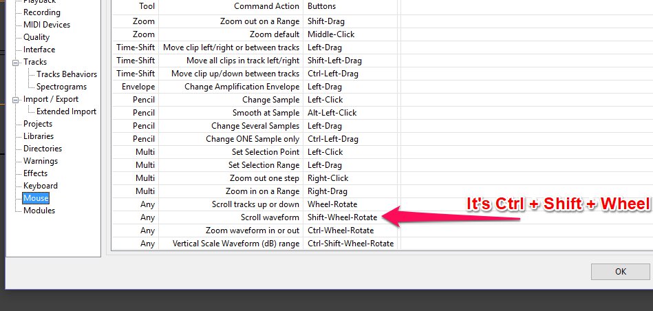

I just found out that when you press Ctrl + Shift + mouse wheel, it’s scrolling!
I leave this for others to to be helped.
But why make such a change? Can I revert it back?
At least the menu entry must be corrected!
I’m looking for a preference or preset that turns Shift-Scroll on and off and I don’t see one.

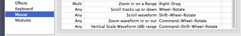

OK. I found it in Audacity > Edit > Preferences > Mouse.
Does yours say that? Does your zoom work?
Well it says exactly as yours. Can you scroll though?

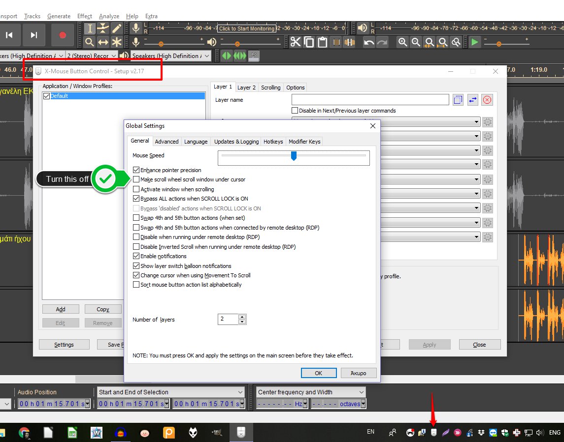

I found the solution! i Posted also a screenshot, forum said it will be “auditioned” first and then uploaded…

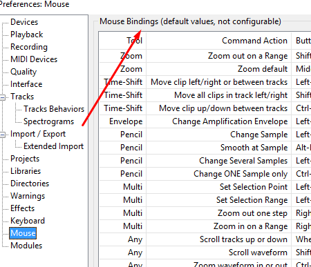

Any way, that menu is not intended to be changed the mouse menu is only for reference, here’s a nice proposition for 2.3.

It’s a lot programs i use, i 'll start closing them down to see what’s causing the interference, and come back at you.
I was ready to answer, but i though i try “X-mouse button control” (using it to switch to between virtual desktops like compiz in ubuntu).
So i found it! You were right it was blocking shift some way. I found out that deactivating the “make scroll wheel scroll window under cursor” under settings, returned the default behaviour in Audacity.
Thank you for your assistance Koz.
