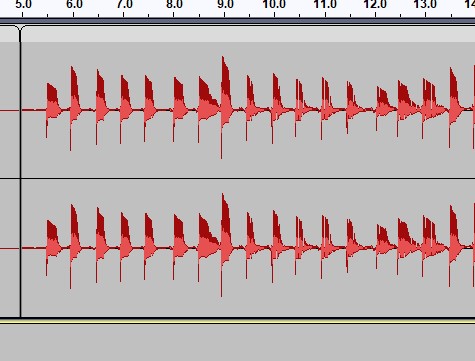

Tracks laid down by our bass player are badly asymmetric. But to be clear not at all DC Shifted (see attached)
You can apply an “All-Pass filter” to the track. This requires some experimentation because the results (like the “Graphic Phase Shifter” in the video) are unpredictable.
Run this code in the Nyquist Prompt effect (see: https://manual.audacityteam.org/man/nyquist_prompt.html)
(allpass2 *track* 100 1)
The numbers “100” and “1” are just a starting point. If it doesn’t work very well, try changing the numbers.

Yes that works fine, a couple of passes with those settings is best.
Doesn’t get rid of that initial negative spike, nor does a Spike removal.
But then again I don’t hear it anyway.
