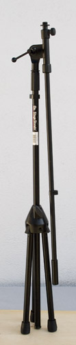

That’s where the boom microphone stand comes in.
That’s an on-Stage-Stands microphone stand, OnStageStands9701B. It’s light-weight and folds up to store in a corner of the closet.
It allows you to place the microphone about the level of your nose or slightly higher, either directly in front or slightly to one side and frees up space underneath for your script.
That spidery thing on the back of the microphone is the shock mount to keep floor and desk vibration noises away. Those are rubber bands.
The little folding Snowball stand has problems: You naturally want put it on the table in front, right in the line of your breath blasts, it’s usually in your eye-line where you want to read your script, and it’s right there on the table where it can pick up slap and comb filter effects from the flat surface, and vibrations from the neighbors downstairs.
