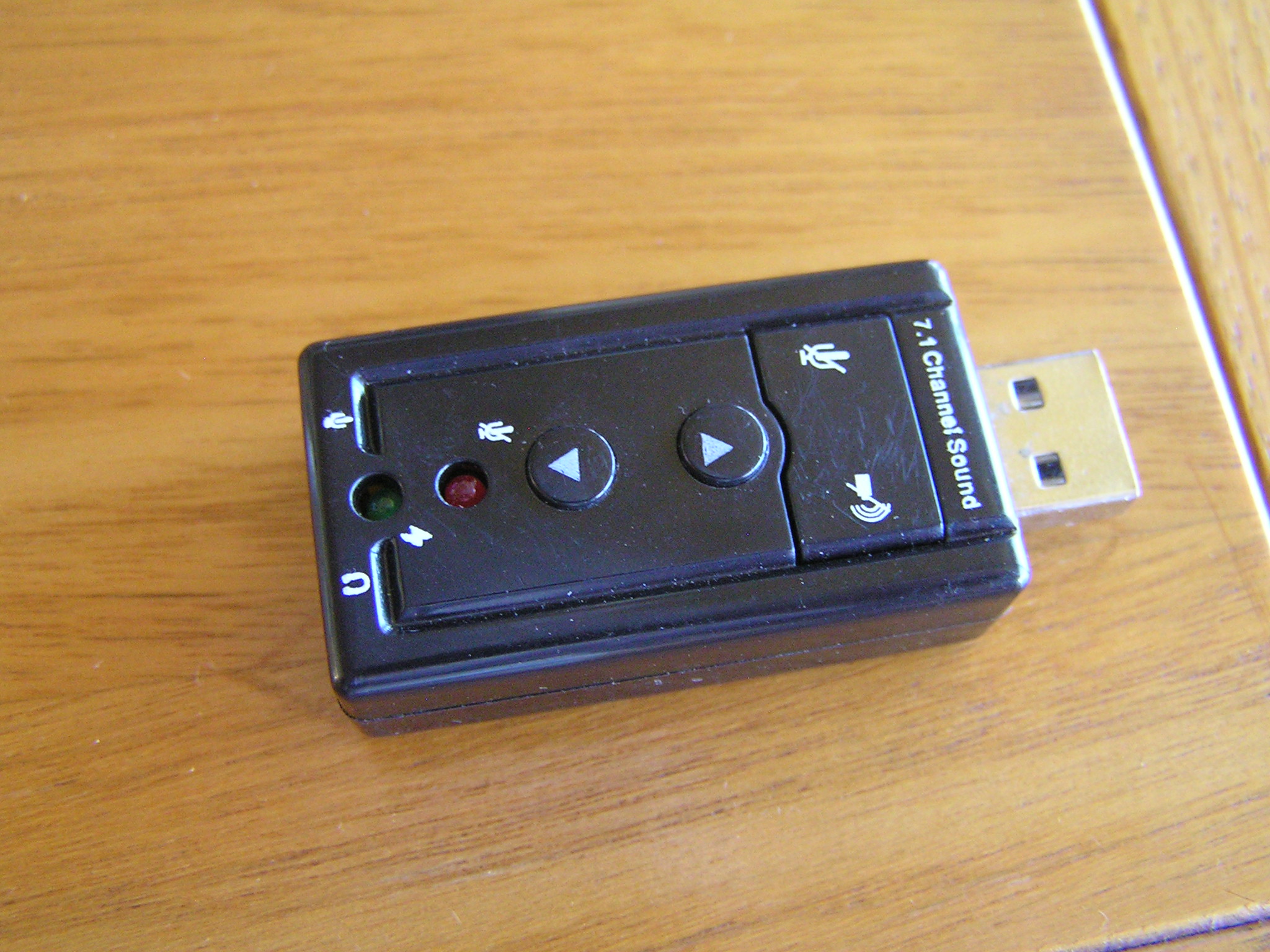

Unfortunately, my HP Pavilion G6 doesn’t have a line-in plug. The way you suggest is the way I did it on my old Acer, which worked fine. I’m stuck with using this little converter thingy which takes the RCA jack in and plugs into a USB port. It has a volume control which doesn’t seem to do anything. The volume on the pre-amp of course doesn’t do anything either (presumably because it’s connected to the speaker outputs). What’s interesting is that when I plug the USB lead in and start Audacity in readiness to record, the volume slider bars are both at zero. Even if I leave them there, I still get a full signal from the pre-amp and the input and output level bars are right up at the right hand end - below the -6 optimum that the help dialogue suggests as being the best. Playing with the click and noise remover facilities does help quite a bit but there is still distortion.
Which “little converter thingy”? It might not be up to the mark…
We live on fine details like model numbers or web sites. We can’t see what you’re doing and Remote Vision died out with my maternal grandfather.
Maybe the Audacity forum threads should be managed through videoconferencing… :unamused:
Point taken about fine detail - The “converter thingy” has only the words 7.1 Channel Sound" on it. I’ve attempted to upload a picture of it attached to this. The line in feed goes into the mike plug at the left end. You can play with the volume buttons in the middle, though there is no noticeable difference registered by Audacity that I can see.
It cost me AUD35 at a local hi-fi gizmo shop, so I’m not expecting miracles - and indeed - perhaps this is the culprit because it’s not working properly. It’s just that I’m puzzled why the volume slide bars go to zero when it’s connected and seem to stop working.

The only time you should be using a “Mic-In” is if you have a MIC (Microphone) and you want to put it IN (record it).
http://kozco.com/tech/audacity/pix/computerAnalogMicrophone.jpg
Other combinations don’t work. When asked why I frequently recommend the Behringer UCA-202 and its cousins, it’s simply that they do offer a good quality Stereo Line-In (not Mic-In), they’re simple to use, they’re cheap and they work with no additional software on all three major computer platforms.
Hard to beat that.
http://www.kozco.com/tech/audacity/pix/peaveyUCA202Lenovo.jpg
If the converter you have only has a mic input and not a line input then the converter is a mic to usb converter and is not suitable for what you are trying to do. If you could reduce the amp output by 100 times with a device of some kind then it may work but a better option is to return the converter to the shop and explain what you are trying to do and swap it for something more suitable.
