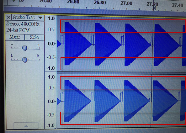

Hello All,
I use TASCAM US-366 to record, but the peak is always flattened.
Change the volume of Mic doesn’t effect the recording.
How could I make it not flattened?
OS: Windows 10
Audacity Version: 2.1.3
Recording Equipment: TASCAM US-366

You appear to be overloading something somewhere.
Where is the input signal into the TASCAM coming from?
TASCAM US-366
Sample width : 24bits
Sample rate: 48 kHz
Sample Clock Source: Digital Input
Digital Input : Coaxial
Digital Input Status: valid 48 kHz
I/O select: Input
Mode : Stereo Mix
What goes into the TASCAM US-366? Where does that strange triangular waveform originate?
What goes into the TASCAM US-366? ← TV SPDIF audio digital signal
Where does that strange triangular waveform originate? ← That is a test pattern to test Aggregate Reset and Play Latency.

That could be the issue. Try recording directly from the digital input or the microphones.
Mode : Stereo Mix
Use same mode in audacity MAC version is OK, but in windows version is flattened.
Mac does not have “Stereo Mix”.
Hi Steve,
TASCAM US-366 only has two Mode: Multi-track / Stereo Mix and it can’t disable.
Usually we use Multi-track mode for MAC, and Stereo Mix for Windows.
Multi-track mode for MAC is normal.
Stereo Mix for Windows has peak flattened problem.
We also try that Multi-track mode for Windows can’t get waveform.
So that’s a setting on the TASCAM US-366 ?
This is just a guess/hypothesis…
There is a similar common issue when recording in mono with a stereo (2-input) interface while only using one channel. (See the [u]Audacity FAQ[/u].)
It’s “leaving room” for the unused inputs/channel(s).
I believe this is a driver feature. …Mixing is done by summing, so it’s normal to reduce the level before or after mixing (it’s more of an average or weighted-average than a simple sum). The idea is that you can run all of the channels at 0dB (“100%”) without clipping the summed-mixed output. However, if you are not using all of the channels you can get clipping of one or more input channels with total mix below 0dB. This doesn’t happen with an analog mixer because every channel has plenty of headroom. But with digital, the ADC in every channel is hard-limited to 0dB.
