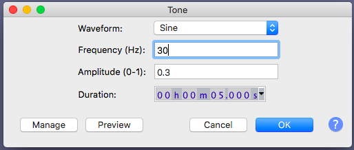

If I was experimenting with this, I might put some really low pitch tone at the end of the show, like 30Hz. Nobody can hear that. Just put something there in place of silence.
Duration will be the hard part. It has to be tone when the show ends.
