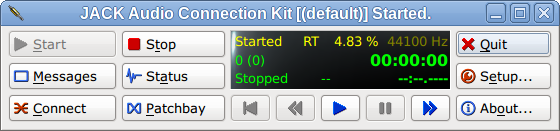

When Jack is running correctly Jack Control looks like this:
If error messages appear we will need to fix that before going further.
