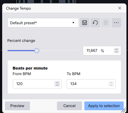

I have the change tempo effect in my web port of Audacity 4:

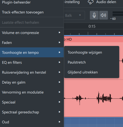

Where is that? I have never used any web version only the downloadable app, where do I find that? In picture you can see what my effect menu looks like. Its in Dutch but as you can see there is no “change tempo” or anyhting, toonhoogte means pitch.
