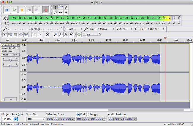

I like to keep one eye on the Audacity blue waves and the bouncing sound meter during the show (attached). The session would not have lasted longer than about 11 seconds if I did that.
“Well, shucks. How come I’m not getting a good recording?”
Since the problem is happening so quickly, you should be able to make changes and see if they worked relatively easily. Pity the poor people that get errors after the first hour of recording.
If you can produce a good, clear show that’s 20 seconds long but it won’t play back, that’s a very different problem.
