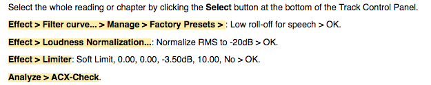

Here is the [u]Recommended Audiobook Mastering Process[/u].
The posted mastering process will cause you to pass ACX RMS (loudness) and Peak almost no matter what you do without causing any sound damage. Then all you have to do is record with low background noise and you will have all three specifications.
This is the abbreviated version of the instructions from the post.

Thank you for sharing this. Can I ask what settings the numbers you listed for the Limiter effect relate to? I have threshold, make-up target, knee width, look ahead and release, and I can’t seem to arrange these numbers to make it work.
