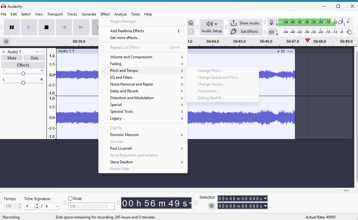

I am currently re recording it from the MP3 on Audacity, the tape is in one of around eight storage containers, but can’t figure out how to slow it down, if I open the Effects menu the sub menu cannot be used, if I open the Pitch And Speed option from the Edit menu only Pitch, not Speed, is useable and I cannot hear anything changing in real time.
I am playing the original file in Windows Media Player and recording to Audacity. Once I finish recording or during recording how can I slow it down to what it should be.

I’m not sure if those effects work in real time. Try stopping playback before applying the effect.
Select/highlight (Select All) before applying effects.
If it’s still greyed-out, go to Effect → Plugin Manager and make sure they are all enabled.
Change Speed and Pitch is what you want. That’s the same as changing analog playback speed.

Thank you for this, I took the action you mentioned and slowed it by 5% then 10% then 15% and it has added ten minutes to the length of the recording but still running too fast whereas when I took it to 25% too slow and if I adjust the Pitch at all it badly affects the sound quality. I will keep trying though, this seems like the best course of action.
