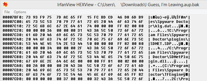

The file I Guess, I'm Leaving.aup.bak is irretrievably corrupt.
Many of the .au files are zero-byte (empty) files with no data at all.
I have looked at a couple of .au files that are not empty, but they contain garbage.
Unfortunately the project that you posted is not recoverable.
Hex editor shows the “aup.bak” file contains some spurious text …
