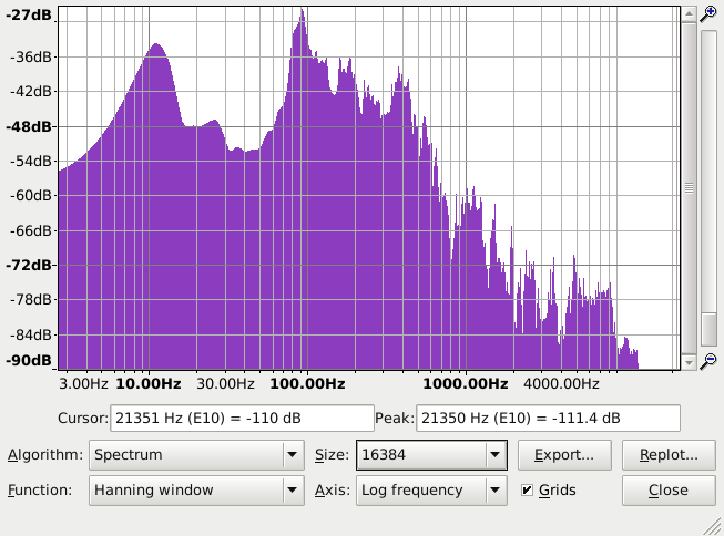

“Subsonic” means “below sonic”, which is a term usually used in the context of the speed of sound (a subsonic aircraft), but koz is using the term in relation to the frequency range of audible sound, ie “[infrasound](https://en.wikipedia.org/wiki/Infrasound)” (sound below 20 Hz).
As shown below, there is a strong peak at about 11 Hz.

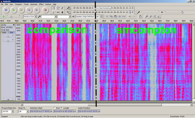

If you look at the spectrogram\*\*\*\*\* of your sound it has many horizontal slices missing …
 ![smcompton's spectrogram has horizontal slices missing.png](https://forum.audacityteam.org/uploads/default/original/2X/6/61fbee01335f21d9e689c3ce9e5320fde9018e9c.png)
Those missing slices are caused [destructive interference](https://en.wikipedia.org/wiki/Interference_%28wave_propagation%29#Mechanism) from the sound reflecting from the nearby walls.
The missing slices are what gives it the in-an-elevator sound, [similar to a [comb](https://en.wikipedia.org/wiki/Comb_filter) effect].

If your voice is being played back in your earphones as you speak, and can be picked up by the microphone , that can also cause the comb-effect. You could try recording once with the headphones disconnected just to see if that is causing the problem.
[\*\*\*\*\* you’ll have to turn up the “window size” of the spectrogram from the default setting of 256 to 2048 to see the slices]
