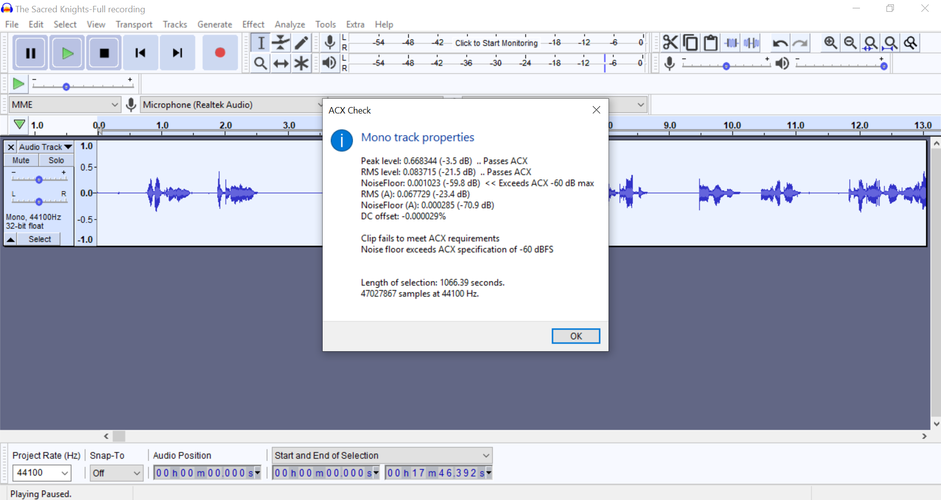

Okay, I’ve gotten the RMS normalizer and the ACX-check downloaded. I did apply the RMS normalizer at 20.00dB, then added a filter curve for low roll off for speech, as well as the Limiter, and this is what I got.
However, even though it passes more of the ACX check than it did before, when I press play on these new settings it’s wildly loud and fuzzy. I attached a screenshot of it.
Your recording has one good voice and one noise track.
Start with the raw recording. Use the drop-down menu on the left and Split Stereo to Mono. Delete the bottom noise track.

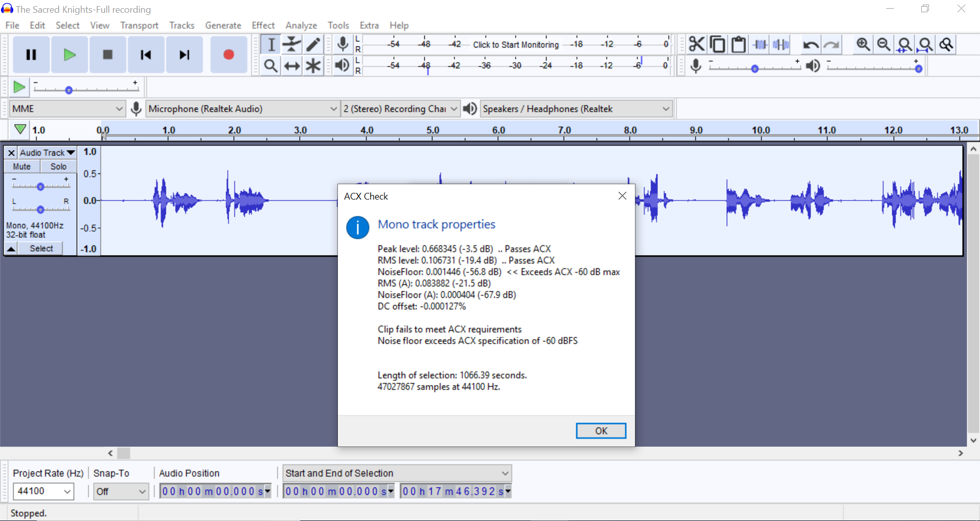

I do have the raw copy. When I go to normalize RMS level, theres an option as well for, “Normalize stereo channels” and it’s set at a default at “independently” but the other option is, “linked stereo” which is correct?
Okay, I did those steps exactly in that order with the raw copy. (Don’t worry, I have a separate one saved as a WAV file) Once choosing the default option with RMS normalizer and once choosing the, “linked stereo option” and I’m still getting this every time.

Quick follow up-I tried doing the same mastering steps with another raw audio sample I’d made as a test, and I’m consistently getting the same results. Everything passes the ACX check except the Noise floor, and I have no idea how to fix that.
