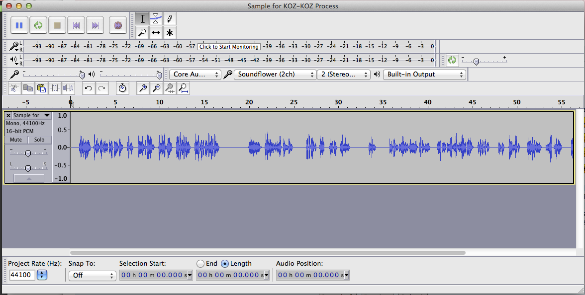

Two attachments. The first is the raw KOZ-KOZ clip you sent. Second is Normalized featuring the usual settings. Isn’t that what yours looks like?
I’m just now recognizing it. Did you leave off the last Normalize in KOZ-KOZ? When you went Normalize > Compress > Normalize, except you stopped after the compression step. That would fail everything but noise.
