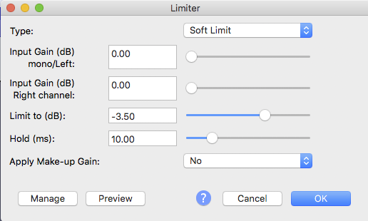

Audacity preserves any sound that goes over 100% (0dB) as long as the show is open and Audacity is running. There are some tools, filters, and effects that accidentally create overload and you need to be able to fix that before the production goes out the door.
My vote is for Effect > Limiter.
Set for Soft Limit, 0.00, 0.00, [wherever you want the limit to be], 10 > OK.
The Audiobook people use it like this.
Their maximum volume is -3dB and this setting has a little slop room built in. You should not be able to hear this working.
