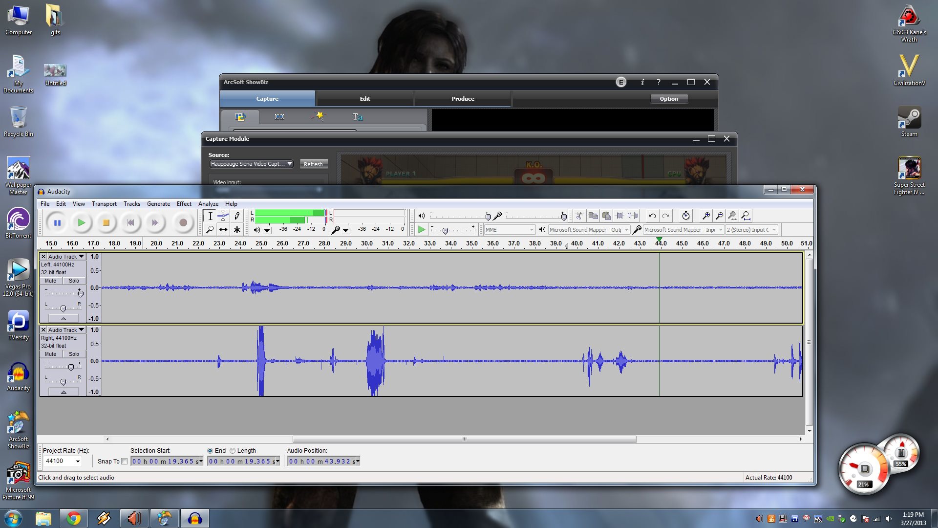

I was tinkering with the settings again and I somehow got it to work.

for future reference if someone else has this issue, the screen on audacity looked like this
