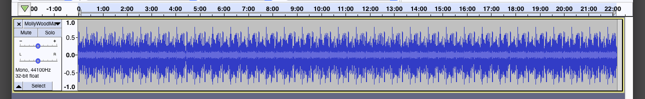

Totally. Say you have a short chapter on your timeline. For example, 22 minutes worth of blue waves.

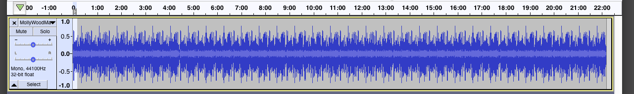

Drag-select a tiny chunk from the beginning. See that tiny white segment on the left?

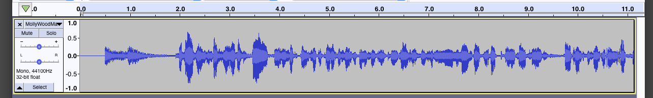

That’s what that tiny piece looks like magnified—zoomed in.

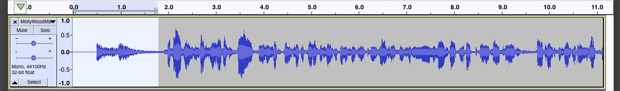

Do it again. Drag-select a small chunk.

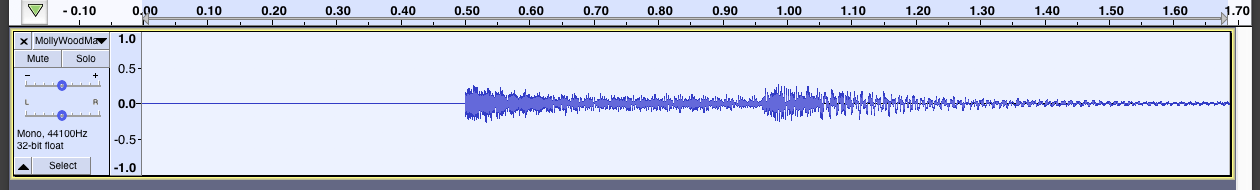

Control+E
And there’s your half-second of “silence” (Room Tone).
You can inspect it, shorten it, do whatever you want. Edit your brains out.
