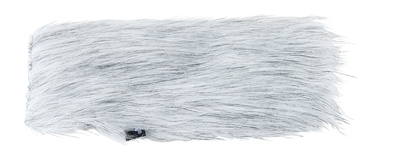

Have you tried a windshield?
Something like Rode’s deadcat:
Many people make wind screens like that. Read the reviews. The furry ones tend to work really well. Also, nobody does live movie capture without the 100Hz roll-off filter in place. Most of the wind rumble and thump is below 100Hz and nobody’s voice is that low.
