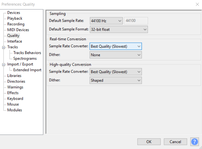

I’m attaching some pics of the RT settings + Audacity recording and quality settings for extra confirmation I’m doing it right.
