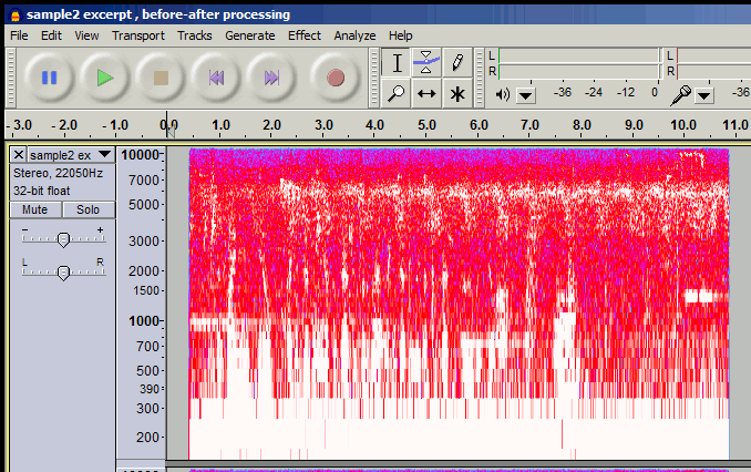

Also, Trebor, how did you know what frequencies to take out? And how wide? Do you look at a waveform, do you just know that 150hz and 5800hz are common noises for birds/main?
Learning to fish,
Marcus
I looked at the spectrogram display, rather than the waveform display, which showed a strong constant signal around 5800Hz …

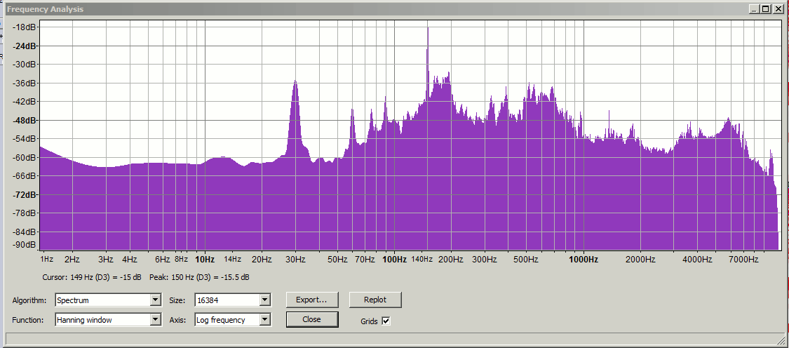

The strong 150Hz signal, the 3rd harmonic from 50Hz mains hum, is more obvious on the frequency analysis than on the spectrogram …
