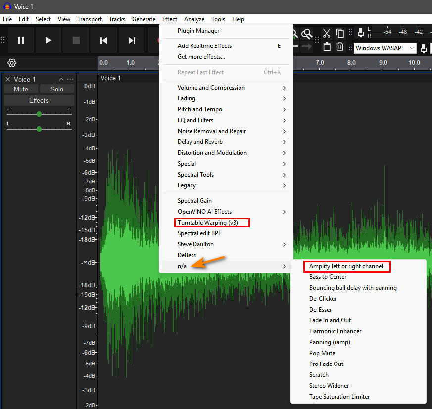

Well, the answer to this “n/a” category situation is important for me to.
As described by Lwinterberg, the reason can be a no “$ vendor” flag at nyquist header of a plugin.
But other legacy plugins do not have a “$ vendor” flag and they have a category.
I have 5 or 6 plugins (De-esser, Amplify left or right channel, and so on) in this category “n/a”.
So, nyquist plugin version has no relation to “category” menus ?
I kindly would like to have an answer of an Audacity expertise related to it.
I tired to see this “n/a” category in Effects menu …
Please how to get rid of it ?
Please, developers and Audacity experts, have an eye of spy to this strange behavior regarding to “n/a” category of Effects menu.

But when you view then on Effects image bellow), one of them are identified by the name (not classified in any Category) and other one remains on “n/a” Category.

Ah, sorry, in nyquist it’s indeed called ;author, not vendor. If you open Presets and Settings inside the effect and then go to Info, you’ll see that the vendor field there matches whatever you put into the author field.
I’m afraid I’m unable to reproduce this. I just added ;author "Other ..." to a 2 of my plugins, and they show up just fine under that submenu.
The only two ideas I’d have are:
  1. In you paste, I notice that you use “Others …” using gramatically correct quotation marks “” instead of the ones Nyquist wants "". I assume this is some sort of prettification done by the forum software, but please double-check that you use the correct ones.
  2. I noticed that the name didn’t update immediately when I changed the ;author field, I needed to go to Effects → Plugin manager → Rescan plugins first. After that, it showed it under the correct category. Is that not the case for you?
Yes, that works. Thanks!
Thanks, Lwinterberg.
I will have to check it at home computer when I have Audacity running.
Probably the quotation marks are the problem because I did not pay attention to that.
But if Apesbrain says it is working fine now, nothing more to say except thanks for your help.
