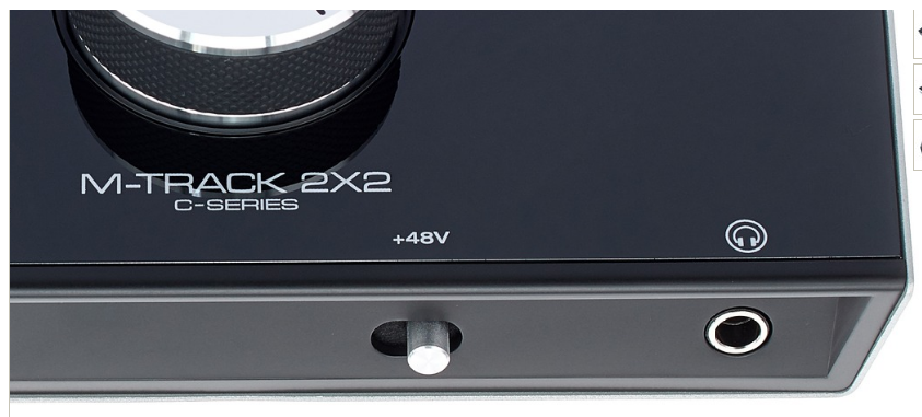

Rode Mic NT1-A mic requires “Phantom Power” to operate properly.
There’s a “+48v” phantom-power switch on the M track interface, that needs to be on …
[ I dunno if the phantom-power is on or off in this picture ]
There’s usually a light somewhere.
https://m-audio.com/m-tracks/2x2
Yes. There’s a power light and a 48volt light.
You should be able to get the orange sound meter light to come on with speech. That’s slightly high for normal announcing, but you should be able to do it without screaming. If the interface is OK, then something is happening in the computer.
