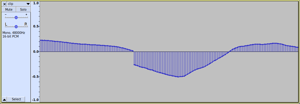

It looks like a “drop-out” (a small part of the waveform is missing). Have you disabled drop-out detection? (See: “[Detect dropouts](https://manual.audacityteam.org/man/recording_preferences.html)”)
![First Track000.png](https://forum.audacityteam.org/uploads/default/original/3X/e/f/ef69bc299f67d7e7f8322b26563841a163b53a8f.png)

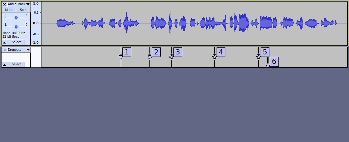

![warn.png](https://forum.audacityteam.org/uploads/default/original/3X/e/7/e7f42f070757ee930905f43f46c7ad050c91279e.png)

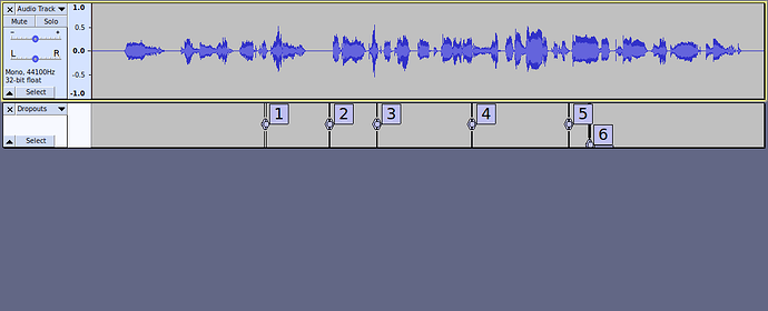

Then you get labels where the dropouts (clicks) occur:
 ![Tracks000.png](https://forum.audacityteam.org/uploads/default/original/3X/0/f/0ff80386a4b9dc5c9e58808ee2c038ae929a5036.png)
