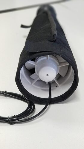

And speaking of heat. How are you going to air condition or heat the area? How long can you stay in there before you can’t breathe any more?
I’m worried about this, but I saw this and am hoping something can be rigged:
Alternatively if the rest of the room gets treated well enough and most of the reverb goes away, I could always crack the door behind me and take breaks. My goal isn’t to soundproof - just to make it dryer. Sorta like the video you linked me to - the guy was facing his closet but had a big room behind him only it would be even less (just a crack).
