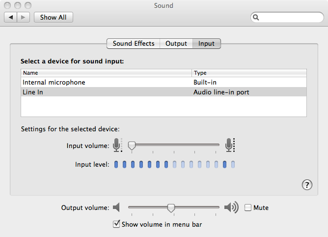

There are variations. Leave Audacity closed and go into your Mac system preferences.
Apple > System Preferences > Hardware > Sound > Input. You should see a bouncing blue light sound meter and a volume slider. See if there’s any position of that slider that results in upper third bouncing of the sound meter without clipping.
With the slider all the way to the left, the peaks are nearly all the way to the right.
Found it.

On the iMac I use for recording LP’s, I see in Audio MIDI Setup that the range of dB values for the line-in is 0 to 22.5 . On the other hand, the range on a different, newer iMac that I have is -12 to 12 . So for whatever reason, the older iMac can’t gain down below 0dB. I will try to record my hotter LP’s with the newer iMac and see if I can get it to gain down to an acceptable level.
Weird - it’s like the line-in on the older iMac is trying to be a compromise between a line-in and a mic-in .
Yep, the newer iMac (with a -12 to 12 dB range) had no problem getting the gain level correct. So I’m chalking the older iMac’s audio up to just being weird.
